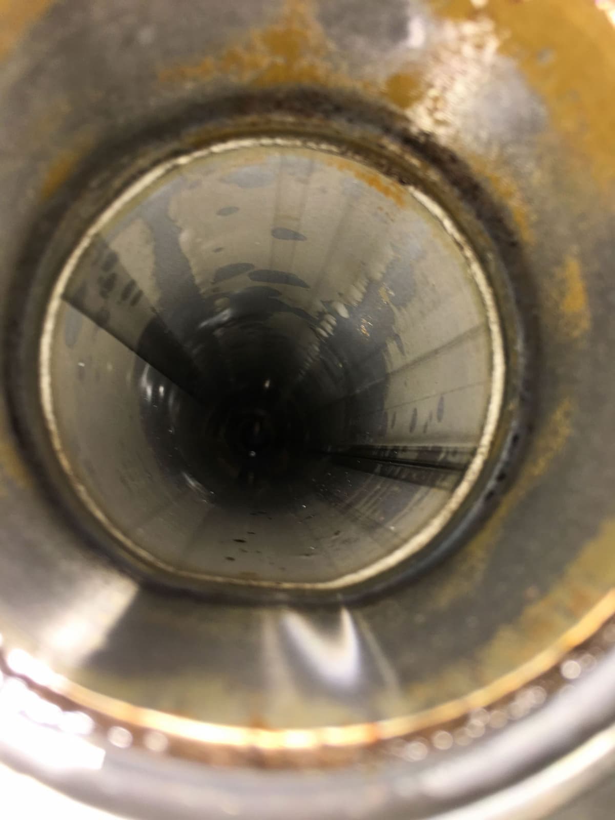

cleaning after 50 minutes
IMAGE 4: Cleaning result after 50 minutes CIP without power ultrasound
cleaning after 30
IMAGE 5: Cleaning result after 30 minutes CIP combined with power ultrasound

The first project occurred in spring 2019 in a European cereal slurry processor. Hot steam was pushed into a product containing 45 percent dry material—a mix of different cereal flour and sugar—with a target temperature of 260 F. The total length of the hot product pipe was 50 feet.
The absence of a nozzle and high viscosity caused severe and random product burn-on and  contamination, forcing the plant to run CIP every seven days. CIP without an additive did not clean the pipe in a satisfactory manner and burnt fouling remained. High-power ultrasound of a specific frequency was applied externally via a mechanical attachment to maximize homogenous propagation of sonic waves in the pipe’s inner wall.
When used during CIP, ultrasound removed burnt product residues, forming an inhomogeneous hard layer of 0.02 inches to 0.05 inches of fouling inside the length of the pipe. Also, ultrasound removed fouling within minutes.
The project showed two benefits:
CIP time can be shortened from 50 minutes to 30 minutes.
Chemical additives, used at 3 percent concentration in caustic, can be quickly reduced to 0.5 percent.
