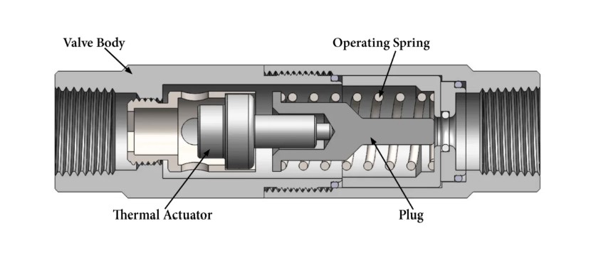

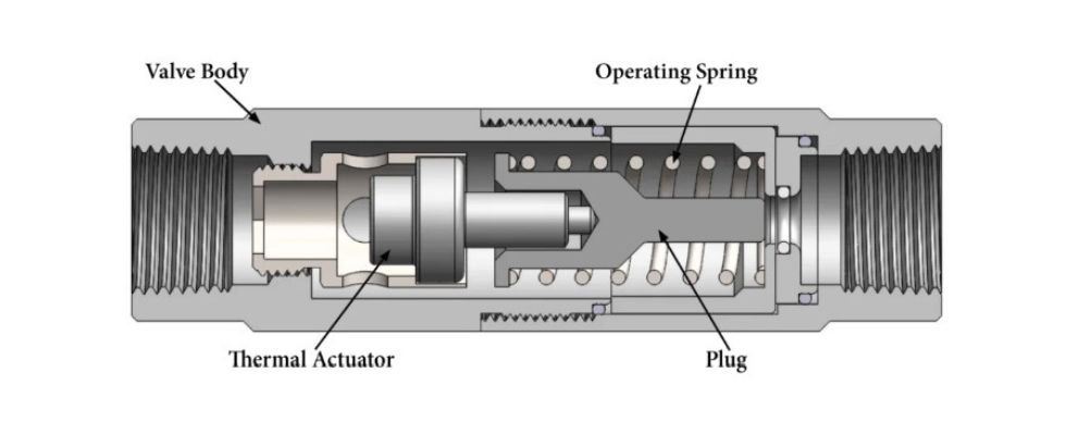

A cost-effective and efficient approach to cooling water pumps is thermostatic thermal relief valves, which are designed to automatically discharge over-temperature water to avoid seal degradation and pump system damage. When water inside a closed system heats up beyond a safe level, the valve modulates open to discharge it and allows cooler water to enter through the pump suction. The valve’s main function is to maintain safe temperature levels. This translates directly to longer mean time between failures (MTBF), fewer maintenance calls and increased equipment uptime.
What Is a Wax Motor?
At the heart of thermostatic valves is the wax motor, a simple yet effective device that can be used in various critical applications, from regulating engine temperatures in automobiles to controlling water temperature in washing machines.
A wax motor is a linear actuator that uses the phase change properties of a paraffin wax blend to convert thermal energy to mechanical energy. The wax, when heated, undergoes a significant volumetric expansion as it transitions from a solid to a liquid state, which can be as much as 20% of its original volume. This expansion extends the piston within the thermostatic valve, producing a usable stroke that opens or closes the valve.
What makes this technology so unique is that thermostatic valves modulate based on temperature alone, not pressure or flow. Unlike pressure regulating valves or flow control devices that can be influenced by system pressure fluctuations, a thermostatic valve's response is solely controlled by the localized fluid temperature it senses. This characteristic ensures consistency, even in demanding and dynamic industrial environments where pressure spikes or flow variations might confound other control methods.
