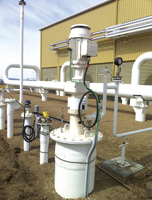

After several meetings with the energy company to understand the process and the challenges of their two-pump system, the pump manufacturer’s engineers designed a custom 10-stage vertical, semi-submersed, progressive cavity sump pump that can lift the heavy oil out of the tank and that has the capacity to achieve 700 pounds per square inch (psi) (48 bar) of differential pressure if the system required it in an upset condition.
The pump manufacturer addressed many technical issues, including the use of a mechanical seal, to the energy company’s specifications. A common pump length with a drop tube and strainer was specified to accommodate any changes in sump depth. The pump manufacturer also performed chemical compatibility tests on several different elastomers. The unique pump selection allowed the manufacturer to eliminate universal joints by incorporating a flexible connecting rod. Design engineers also considered the electrical service at the site by selecting a 20-horsepower driver that corresponded with the existing two-pump electrical arrangement. The housing was designed to accept the user selected mechanical seal with the capacity to operate at 700
psi (48 bar).
The selected pump was ideal for this application, with dimensions (length, height, mounting flange) to fit the energy company’s existing underground tank. This pump also operates in reverse, requiring the seal to be on the discharge side and the entire housing to be pressurized. The rotor and stator system is located at the lowest point, which helps prevent dry running. The space-saving design of the entire pump (except for the drive and discharge flange) disappears into the tank, providing a clean installation. Additional heating and isolation of external equipment is unnecessary—an important attribute in ambient operating temperatures as low as -40 F.
