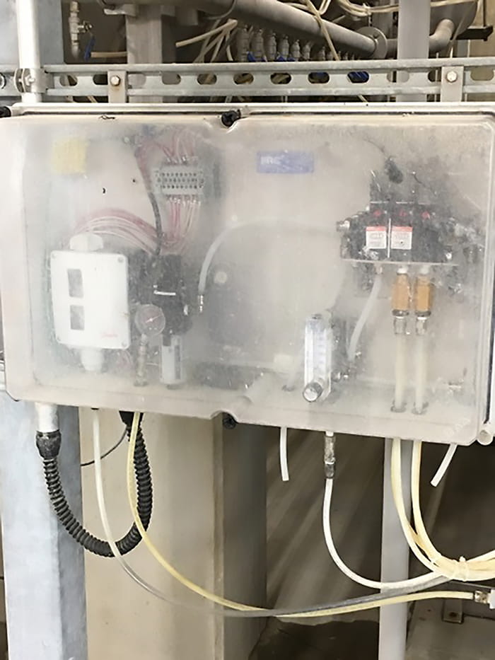

Making smart measurements of the compressed air system will reduce maintenance and energy costs as well as ensure proper operation for all equipment requiring consistent air delivery. The measurement equipment is relatively inexpensive. Monitoring power use, air flow and air pressure ensures a properly working system, but other measurements like dew point and temperature can also help a system operate with better results. By measuring the air flow, pressure and energy use, users can generate a baseline of the system operation. Typical flow data in a compressed air system is measured in cubic feet per minute (CFM).
Volumetric flow meters are typically used to measure compressed air since they do not require any straight runs of pipe before or after the meter installation (see Image 1). They also are unaffected by turbulent flow conditions, which can create inaccurate or no flow readings in a velocity type of flow meter. Some volumetric flow meters will read accurate flow readings even with differing system pressure by using pressure compensation into a flow monitor. One of the greatest benefits for using a volumetric flow meter, also called a variable area (VA) meter, in a compressed air system is that the meter is totally unaffected by water or moisture in the compressed air. Unlike velocity meters or thermal mass flow meters, the volumetric technology is only able to read flow ranges within a 10:1 flow ratio, also known as the effective flow range of the flow meter.
Thermal mass flow meters are also an excellent choice for measuring flow in the compressed air line as long as the meter is installed after the air dryer and the air dryer is functioning properly. Thermal mass meters typically measure a flow range of 100:1 independent of temperature and pressure changes so they can read very low flow rates, which enable detection of air leaks in the system.
All thermal mass flow meters are not the same. There are a few flow meter manufactures that use a small capillary tube to measure the air mass flow. When using this capillary thermal mass flow technology, measurements must be taken to make sure the air system is filtered to less than 1,000 microns and supply is very dry. Knowledge of the pressure drop these flow system will create is also something that will have to be considered in the design of the DAF air system before use. When users implement
smart metering, they can optimize velocity and operating pressure to reduce pressure drop and increase performance of the DAF.
