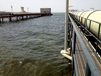

Algae bloom at desalination plantA bloom has turned the water at a desalination plant intake a dark greenish-brown hue.
