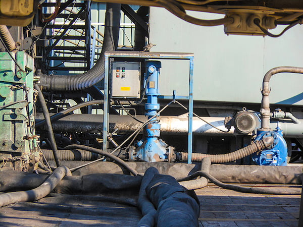

drilling siteImage 1. Crude oil drilling sites are at risk due to high solids content of slurries. (Images courtesy of JWC Environmental)
Increasingly, drill sites and refineries are now relying on powerful in-line, two-shafted grinders to protect their pumping systems as well as costly downstream processing equipment. These grinders are powerful enough to grind down rocks, wood debris and paraffin sludge to ensure pumps do not clog and that liquid-solid separators and centrifuges receive properly-sized content for separation. This enables them to operate at optimum throughout without interruption.

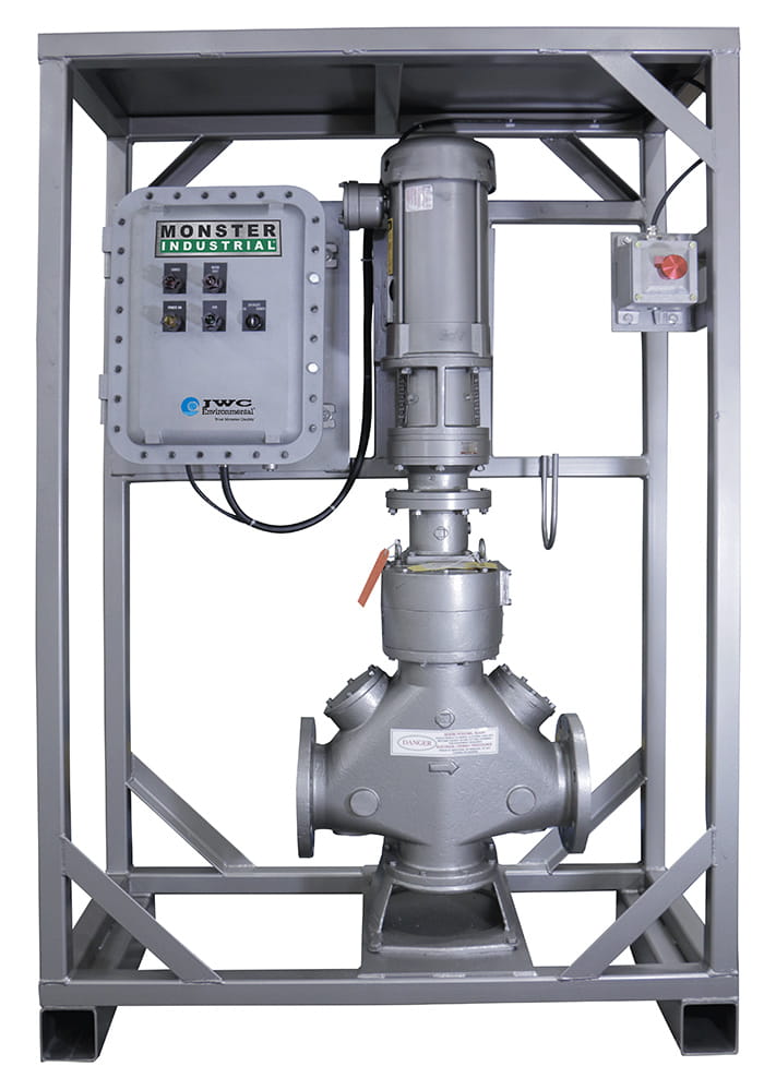

With the increasing use of two-shafted low-speed and high-torque grinders being employed to protect pumps in petroleum-related applications, the suppliers of grinders have been adapting.
grinder pumpImage 4. Grinding up big cuttings increases surface exposure.
One of the common needs in the industry is the easy relocation of the grinders from site to site as drilling or tank cleanout operations move. To fulfill this requirement grinders are now being built into plug-and-play skid packages that can be moved by standard job site equipment like forklifts or cranes wherever they are needed. These skids have pre-wired programmable logic controller (PLC) control packages that only need power to run autonomously. Additionally, most oil and gas operations are working within hazardous areas with the possibility of explosive gasses. The grinders are outfitted with controls and motors certified for use in hazardous locations.
