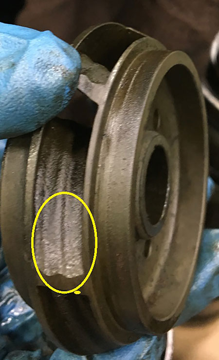

The physics behind cavitation involve the rapid phase change of liquid to vapor and back to liquid. When vapor bubbles collapse, they do so asymmetrically, creating high-velocity microjets that can reach pressures of several thousand pounds per square inch. These intense pressure spikes occur in microseconds, creating a continuous bombardment of the pump’s internal surfaces. An example of early cavitation is shown in Image 1.

IMAGE 1: Example of impeller cavitation (Images courtesy of Volta Insite)

The damage caused by cavitation extends beyond simple wear and tear, encompassing mechanical, operational and economic consequences that can cripple industrial operations. The most visible damage appears as pitting and erosion on impeller surfaces, where the violent collapse of vapor bubbles literally tears material away from metal surfaces. This erosion creates a characteristic honeycomb pattern of small craters that progressively worsen over time.

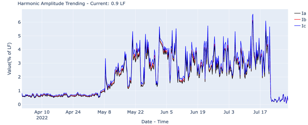

IMAGE 2: Cavitation harmonic trending from baseline to corrective action

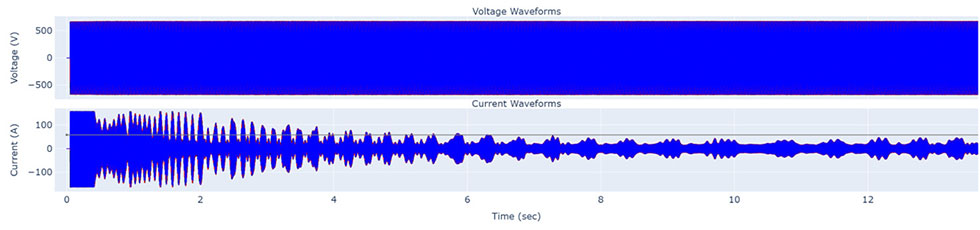

IMAGE 3: Pump startup with cavitation

Electrical signature analysis (ESA) has emerged as a powerful tool for early cavitation detection, offering insight into pump condition without requiring invasive monitoring equipment or system shutdown. This technology analyzes the electrical current and voltage patterns of pump motors, detecting subtle changes that correlate with mechanical and hydraulic conditions within the pump.
The principle behind ESA lies in the direct relationship between pump hydraulic conditions and motor loading characteristics. As cavitation develops, it creates variations in torque demand that manifest as specific patterns in the motor’s electrical signature. These electrical anomalies appear long before traditional vibration monitoring or performance measurements can detect cavitation onset.

ESA excels at detecting intermittent cavitation that might be missed by periodic manual inspections or even continuous vibration monitoring. The technology can identify cavitation occurring during specific operating conditions, such as startup transients or varying demand cycles.
