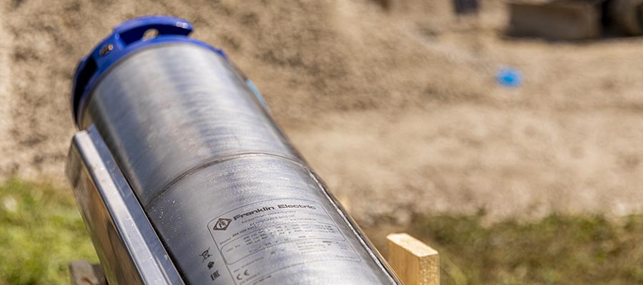

IMAGE 1: Water-to-wire efficiency is the measure of the efficiency of a pump and motor together, as well as the pipe, controls and wire necessary to complete the operation. (Images courtesy of Franklin Electric)
In addition to the pump label, pump manufacturers calculate a pump curve that shows the best efficiency point (BEP) for that pump. To properly size a pump, engineers need to consider the factors shown on the pump curve, including the total dynamic head and the desired flow rate in gallons per minute (gpm). Overestimating or underestimating the total dynamic head or the gpm needed to accomplish a job could have consequences for the optimization of a system. The pump curve maps out these efficiency points. The closer the pump’s BEP is to the desired conditions, the better. If the desired operating point is too far to the left of the BEP, motor power overload, high flow velocity wear, cavitation, higher-than-desired radial loads, shaft deflection, turbulence and erosion of the component parts of the pump could occur. Being too far to the right of the BEP could result in vibration, high temperature, excess recirculation, cavitation or extremely low efficiency. All of these can reduce the lifespan of the system.
