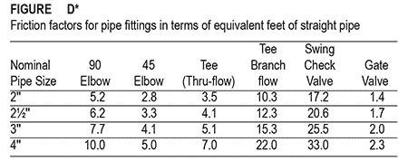

Equivalent length of fittings for pump size calculationIMAGE 2: Equivalent length of fittings. Example: Image 6 has one check valve, one 90-degree elbow, two 45-degree elbows, one gate valve, and one branch flow tee for a total length of fittings of 39.7 feet.

The first piece of determining friction loss is determining the total equivalent length of pipe. Calculating friction loss through a fitting can be difficult and cumbersome. Friction loss varies from fitting to fitting, so rather than calculating the friction loss through each fitting, Image 2 can be used to convert them to an equivalent length of straight pipe. This reduces the number of variables when calculating friction loss.
For example, the friction loss through a single, 2-inch, 90-degree elbow is equivalent to the friction loss through 5.2 feet of straight, 2-inch pipe. To calculate the total equivalent length of the system, convert each fitting to a straight length of pipe and add the equivalent length of all fittings to the nominal length of pipe. Image 6 has 250 feet of nominal pipe and 39.7 feet of equivalent fittings for a total equivalent length of 289.7 feet.
