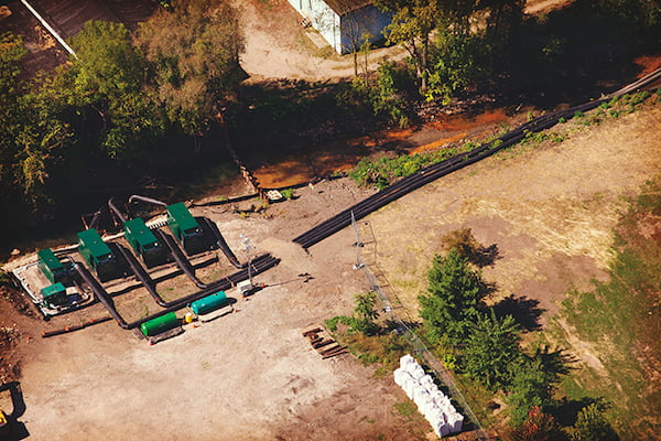

Image 1. An aerial view of the Portage Creek project shows pumps with sound-attenuated enclosures.Image 1. An aerial view of the Portage Creek project shows pumps with sound-attenuated enclosures. (Courtesy of Cornell Pump Company)

To provide access to the creek bed and surrounding area, the creek was diverted in seven segments over two years. Work was completed from late March through mid-October, when risk of freezing was reduced. The project also dealt with various flow rates, depending on rainwater runoff. During the working season, the pump distributor abated sound in the neighborhood while still operating the pumps 24 hours a day to divert flow and avoid backfill flooding. Sufficient pump capacity to deal with a strong rain event and uneven flows was necessary.
Image 2. This shows water from Portage Creek returning from the bypass area through pumps upstreamImage 2. This shows water from Portage Creek returning from the bypass area through pumps upstream, with shoring material in the background used to keep remediate area clean.
The project used three 16-inch discharge pumps with 18-inch suction, 16-inch discharge, the ability to handle a 4.5-inch solid, flow rates up to 17,800 gallons per minute (gpm), heads up to 240 feet, and efficiency up to 85 percent. These pumps were combined with one 12-inch discharge pump with a 14-inch suction, 12-inch discharge, the ability to handle a 3-inch solid, flow rates up to 9,000 gpm, heads up to 200 feet, and efficiency up to 84 percent.
The distributor also used several on-call 4- and 6-inch discharge pumps to dewater Portage Creek. The system bypassed the flow from upstream around the work site and back into the creek below the ongoing mitigation. The pumps were able to handle significant solid sizes because of the unpredictable nature of items that could be found in the creek and the amount of potential plugging solids in the creek bed. The pumps were driven off diesel engines and housed in sound-attenuated packages.
