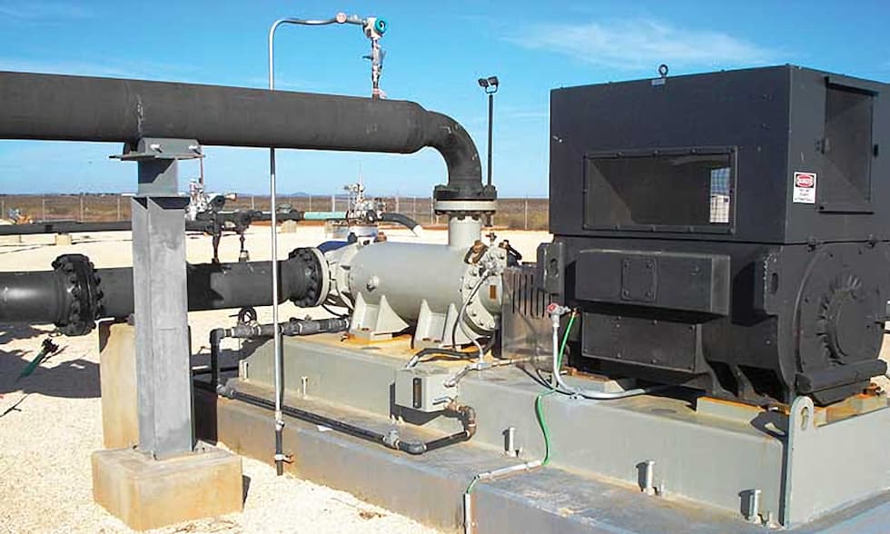

Rotary positive displacement three-screw pump designed for pipeline service

Three-Screw Pumps
PD pumps fall into two categories: reciprocating pumps and rotary pumps. One type of rotary PD pump—three spindle screw pumps—is typically favored for high viscosity pipeline applications. Hundreds of three-screw pumps have been installed in Venezuela and western Canada, with early installations each recording more than 54,000 hours of operation. The pumping elements consist of three moving parts: the power rotor (main screw) and two symmetrically opposed idler rotors, all operating within close-fitting housing bores. The incoming process fluid is conveyed by the rotating power rotor by means of the cavity formed with the intermeshing idler rotors. From suction to discharge, the fluid is transferred by means of a series of constantly forming and reforming chambers until it reaches the casing outlet. Unlike centrifugal pumps and some types of PD pumps, three-screw pumps are self-priming, and they require only one mechanical seal, which reduces maintenance costs.

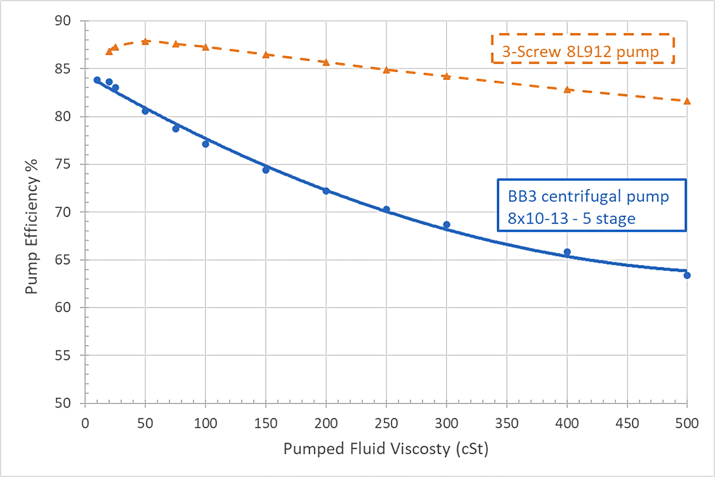

Despite the known impact of viscous fluids on centrifugal pump efficiency, little literature exists measuring and comparing the economics of applying different pump types to the pipeline pumping of viscous oil. A common configuration of BB3 size centrifugal pump in pipeline services, an 8 x 10-13 with five stages and a rotary PD three-screw pump designed for pipeline service were tested. The two systems were evaluated against a range of fluid viscosities from 10 cSt (20 cSt in the case of the PD pump due to operation limits), to 500 cSt, to determine the effect of increasing viscosity on efficiency, power and, hence, energy opex.
The rated point chosen represents an averaging of a popular rating for BB3 pipeline pump installations: 2,500 feet (762 meters), 3,300 gallons per minute (gpm) (750 cubic meters per hour [m3/h]). The specific gravity of the fluid was set to 0.9. This results in a differential pressure requirement of 976 pounds per square inch (psi) (67.3 bar). In each case, the duty point (head, flow and specific gravity [SG]) was held constant and the speed was varied to achieve the rated point. For the BB3 centrifugal pump, maximum diameter impellers were used to achieve the best possible efficiency. API 610 test tolerances were used. The viscosity correction method for the BB3 centrifugal pump was American National Standards Institute/Hydraulic Institute (ANSI/HI) 9.6.7 2015.
Image 1: Pump efficiency at different viscosities (Images courtesy of CIRCOR)
The performance results for different viscosities are shown in Image 1.
The shapes of the efficiency curves differ significantly. The BB3 centrifugal pump efficiency declines with increasing viscosity, from mid-80% to mid-60%. The three-screw pump efficiency increases to reach a maximum at around 50 cSt and then declines slowly. This is due to the interplay of two different mechanisms within the pump: the backflow (which decreases with higher fluid viscosity) and the frictional losses (which slowly increase with higher fluid viscosity).
