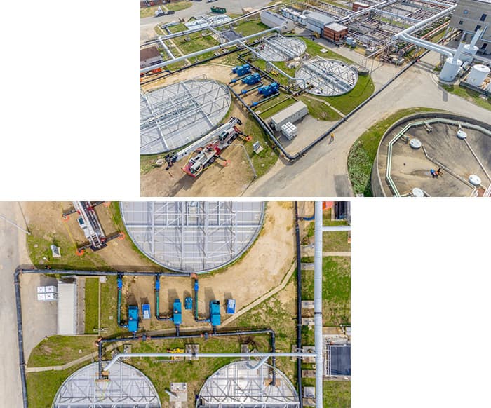

What began as an otherwise nondescript Thursday afternoon in mid-February 2018 in a municipality near Washington, D.C., ended with an unexpected catastrophe that area officials were not prepared to handle alone. A 20-inch cast iron pressurized sewer main ruptured at a Maryland wastewater treatment plant, with the end result being a substantial health and environmental crisis that required immediate attention. The Washington Suburban Sanitary Commission (WSSC) and Maryland Department of Environment (MDE) were notified and called in, as were emergency maintenance crews employed by the wastewater treatment plant and Ross Contracting, Incorporated. Everyone quickly agreed that this was a much larger issue than they could repair on their own. This was going to be a serious multiday project that would require outside help and heavy machinery.
Images 1 and 2. Crews installed 16 dry-prime pumps with sound enclosures and 8,000 lineal feet of pipe and hose at a Maryland wastewater treatment plant. (Images courtesy of Thompson Pump)
