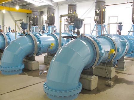

The first criterion to consider is the source and quality of the raw water the intake pump station will supply to the plant. The raw water can come from sources such as groundwater, rivers, lakes, aqueducts and reservoirs. Water quality may vary considerably in solids content, physical, chemical and biological contaminants, temperature and ecosystem. The water quality is the first important consideration in the design of the pump station and selection of the pump and its materials; therefore, a water quality test should be done to help establish pump station design.
Focusing on Application 1, intake pumps, the intake pump station is designed to deliver raw water to the treatment plant with a capacity range to match the plant design. Due to variable treatment plant capacities, the number and size of the pumps selected will vary and must be capable of operating in parallel to deliver the variable flow. The selection of the number of pumps and the control of the pumps should maximize the pump operating time in the preferred operating region (POR), per American National Standards Institute/Hydraulic Institute (ANSI/HI) 9.6.3 Rotodynamic Pumps—Guideline for Operating Regions. Considering the quantity and control of the pumps to efficiently meet the treatment plant variable capacity will help reduce the total life cycle cost.
Pumps used in this application are designed to be suitable for pumping a wide range of flow and water quality, from screened, clear water to turbid water containing particulates such as sand, silt and other biological constituents.

water pump
IMAGE 2: Vertically suspended rotodynamic pumps

Depending on the intake type, any of the following pump types are used:
  • horizontal end suction rotodynamic (OH1)
  • horizontal split case rotodynamic (BB1)
  • vertically suspended pumps rotodynamic (VS1, VS2, VS3), Image 2
  • submersible rotodynamic (VS0)
  • Archimedes screw, Image 3
For more details on the construction and design of these pump types, reference ANSI/HI 14.1-14.2 Rotodynamic Pumps for Nomenclature and Definition, and ANSI/HI 14.3 Rotodynamic Pumps for Design and Application.
