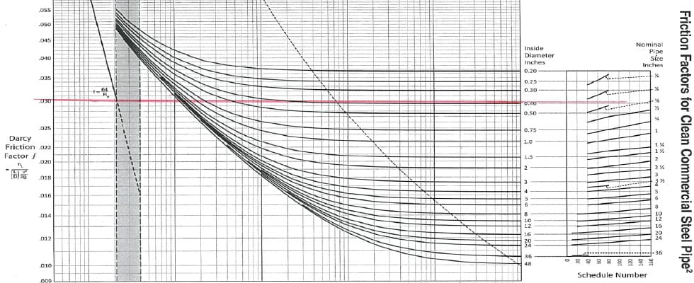

Make a rough estimate of the cost of watering the garden in each case. Make any simplifying assumptions for your calculations. Hint: Shower room water is supplied from the same main water line via approximately 500 feet of pipe (assumed to be roughly the same diameter as a garden hose).

All equations are pulled directly from Crane’s Flow of Fluids.
So, you can ignore the inlet and outlet conditions.
Assume the hose does not have many turns:
- L is 150 inches
- Assume f is constant cases
Case 2
More exact:
