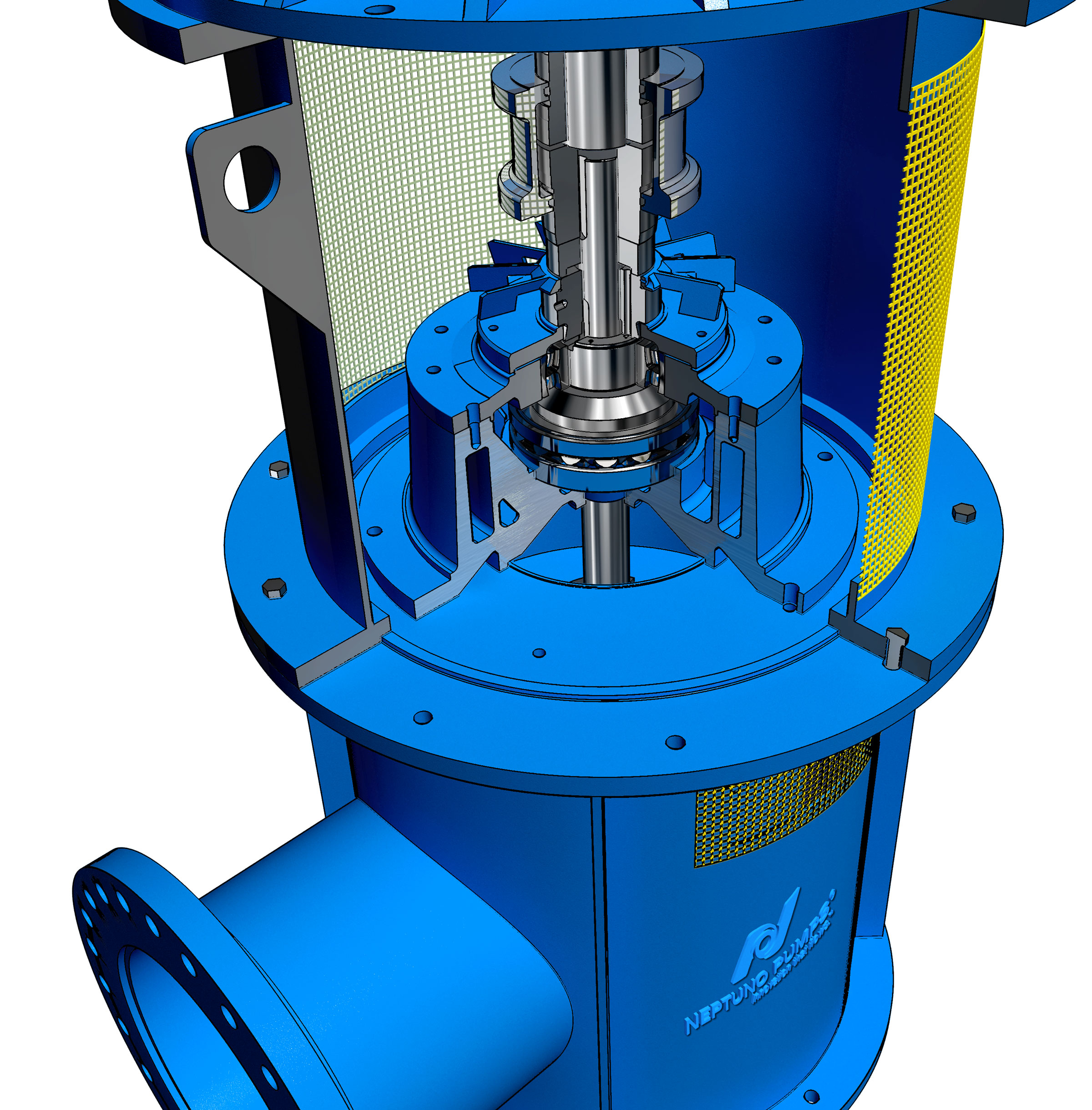

The life of pumping equipment is related primarily to the design of the pump and the resistance of the material used for cavitation, corrosion and erosion under operating conditions. Therefore, the exact properties of the water to be pumped in each project must be known to select the best material. The chosen material must be adequately resistant to the fluid characteristics and the velocity effects in the different areas of the pump. Special materials—such as Duplex steels—are widely used in modern reclaim water pumping systems for all the main pump parts (see Figure 2).
This material is popular because of its strength and abrasion and cavitation resistance. New advanced engineering thermoplastic materials have also been developed to be used in pump bearings and wear rings with outstanding performance in the roughest conditions. These alloys and engineered materials guarantee a high efficiency performance and an improved pump life. Although this type of material may represent a higher purchase cost, it is commonly accepted in the industry that approximately 90 percent of the total cost of ownership is maintenance, operation and installation, leaving only 10 percent as the initial pump purchase cost.

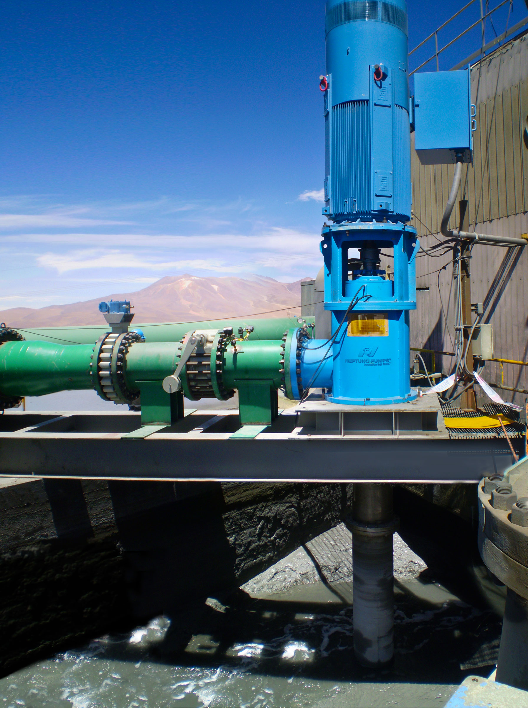

Figure 1. Reclaim water pumping system – 13,800 total installed horsepower in a copper mine in Chile

Figure 2. Vertical turbine pump—All wetted parts made of Duplex 2205 designed to handle large amounts of solids

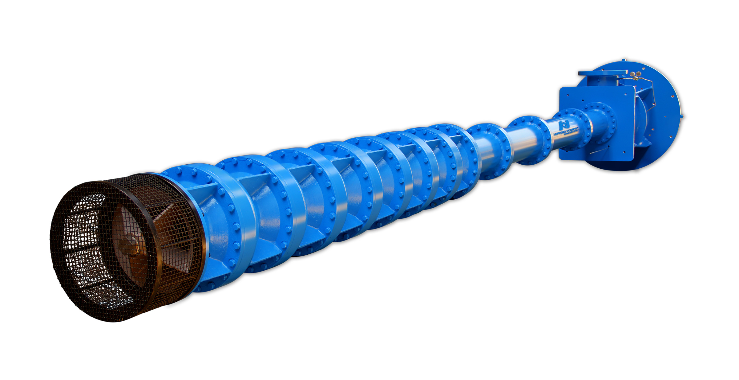

Generally in the mining industry, the required head is so large that pumping must be done in multiple pump stations, installed in series, with several discharge reservoirs constructed at different levels and altitudes. This increases the construction costs, as well as the required maintenance of the pumping systems. Sometimes, even this alternative may not be feasible, as in cases in which geographical conditions do not allow the installation of several pump stations. One solution for this is the design of engineered vertical turbine pumps within a limited range of specific speeds —ns—(1549 < ns < 2585 ), for high heads per stage (see Figure 3) with total dynamic heads (TDH) up to 500 meters or 1,640 feet.
As a result, this would eliminate the need for multiple pump stations, reducing the purchasing and installation costs of pumps and other auxiliary systems such as motors and different electrical equipment. This would also reduce the annual electrical costs. An important parameter in the selection of this type of pump is the maximum value of torque that the pump shaft can support without breaking or damaging the bearings. Fortunately, pump manufacturers use a wide range of engineered materials with superior mechanical properties and high yield strengths that can withstand the demanding conditions of highly loaded shafts.

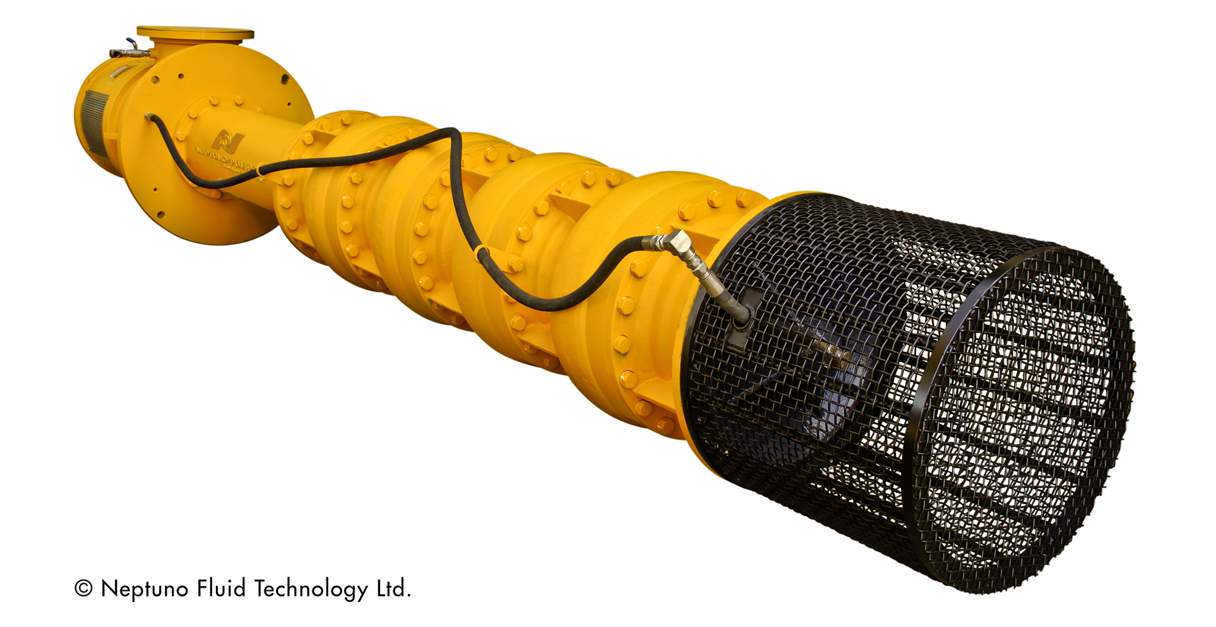

Another major concern is the high, axial, hydraulic thrust forces that result from internal pressures acting on the exposed areas of the rotating elements. To reduce the axial thrust force, one alternative is to hydraulically balance the impellers by drilling holes through the back shroud of the impeller and maintaining suction pressure in a chamber behind the impeller, achieving longer thrust bearing life. Sometimes, these balancing holes are not desirable because they reduce the pump’s efficiency. An alternative is adding an independent axial thrust bearing assembly in the pump discharge head that can withstand the total hydraulic thrust, including the impeller’s and shaft’s weights, keeping the pump and its motor running safely (see Figure 4).

Figure 3. High-head vertical turbine pump—Total Dynamic Head of 500 meters or 1,640 feet with seven stages

Figure 4. Independent axial thrust bearing assembly withstands the total hydraulic thrust.
