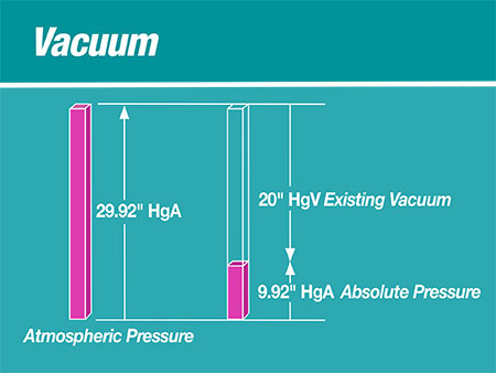

Image 2 shows a graphic description of standard atmospheric pressure measured at sea level. A 1-inch square column of air from sea level to the ionosphere, where there is no air, weighs 14.7 pounds at sea level. Using this form of measurement is impractical. In comparison, a 1-inch square column of mercury (Hg) that weighs 14.7 pounds is 29.92 inches, or 760 millimeters (mm) tall. Mercury is used in a U-tube barometer as a gauge.
If absolute pressure (HgA) is visioned as a positive upward vector, then vacuum pressure (HgV) is envisioned as a downward vector. A calculated pressure absolute (as an upward vector) for a pressure vacuum (as a downward vector) is an upward pressure absolute less than atmospheric pressure absolute.
A vacuum pump is a positive displacement mover of a constant volume of gas. According to Boyle’s Law, P1V1 = P2V2 where P is always expressed as pressures absolute, HgAbsolute, HgAbs or HgA.  Volumes (V) are cubic feet or cubic meters at a respective pressure (P). For vacuum systems, less than atmospheric pressure is expressed as inches of mercury HgV. In the chemical industry, closed vacuum systems with low vacuum need to be described as a very low pressure absolute HgA.
bsolute pressure (HgA) and vacuum pressure (HgV)
IMAGE 3:  Absolute pressure (HgA) and vacuum pressure (HgV) as “up and down” direction vectors.
