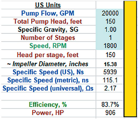

IMAGE 1: Efficiency calculation formula from the pump efficiency calculator3 and Hydraulic Institute chart1 at 3,600 rpm (Images courtesy of the author)

To estimate efficiency, we will use HI charts or a formula from the pump efficiency calculator3 (Image 1).
Note the assumed number of stages was selected as one stage and the shaft speed as 3,600 rpm. Theoretically, there is nothing wrong with that but the resultant power—1,039 hp—is rather large and a 1,000-hp (and probably a bit higher), 3,600-rpm motor, would not be realistic.
There are, of course, guidelines in the relationship between motor, pump and speed limitations but we will, for now, not go too much into these details. Instead, we’ll go by the “gut feeling” that this motor would appear to be running too fast for its power. So, let’s select the next lower synchronous speed (Image 2).
IMAGE 2: Efficiency calculation at 1,800 rpm
There is an amazing gain in efficiency of 10%. If this unit operates nonstop for a year, the difference in power consumption would be around $50,000.
Consider this: Can you prove it? And how would you explain such a difference in efficiency when the selected speed changed for the same hydraulic conditions? The best answer will be published in the next column as Part 2.
