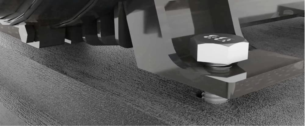

Large, multistage pumps generally have four feet (Image 1). If the pump’s feet or the baseplate feet are not constructed correctly, it can cause the pump to sit down on three feet, as a three-legged stool would, leaving the fourth foot away from a firm surface.
Thus, the interface between the pump foot and base would be soft. Image 2 Illustrates in an exaggerated way how in a natural, unbolted position one foot does not sit down on the baseplate.
Soft foot Illustration
IMAGE 2: Soft foot illustration
This situation should be investigated thoroughly as it may indicate a problem with the baseplate installation or pump foot machining/setting.

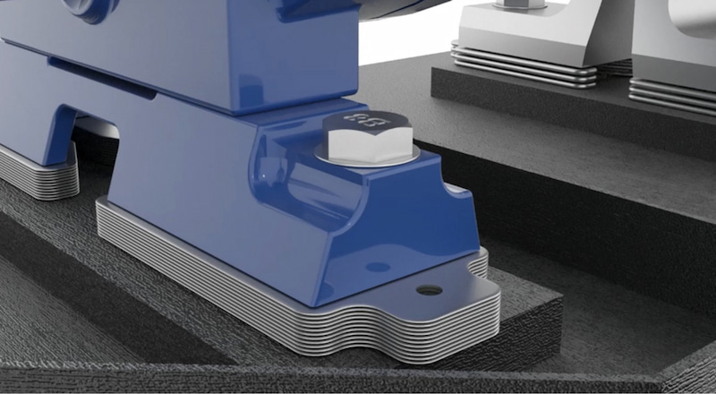

In many cases, it is common practice to use unacceptable arrangements to correct a soft foot. Fixing the problem using shims is not ideal, but if this is the only available option, then the following approach should be adopted:
  • Use only one shim, as a stack of multiple shims under the pump’s foot can act as a spring.
  • Use a shim that covers the entire pump foot.
Incorrect Pump Shims – Pump Feet should be Hard to the Base
IMAGE 3: Incorrect pump shims. Pump feet should be hard to the base.
It is also essential to understand the machine and its operating environment. For example, on a machine in hot service where some amount of thermal expansion is expected, such as a BB4 pump in boiler feed service, pump soft foot and shims lead to serious problems.
