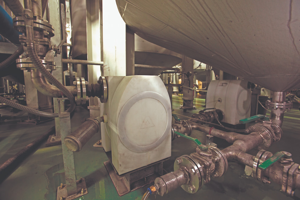

While many types of pumping technologies have been tried and found wanting in these (and other) harsh manufacturing applications, one has proven to be a reliable performer where a wide range of abrasive components need to be handled safely, efficiently and reliably: solid-body, plastic air-operated double-diaphragm (AODD) pumps.
Solid-body, plastic AODD pumps have many beneficial features when handling abrasives. To begin with, they do not require electricity. They are self-priming and can pump a wide range of abrasive media, from slurries to liquids with suspended solids. Plastic AODD pumps are positive-displacement pumps that have a diaphragm in each of their two pumping chambers.
These diaphragms are connected by a shaft so that when the compression stroke takes place in one chamber during the pumping process, the suction stroke takes place simultaneously in the other chamber. This results in efficient, reliable, cost-effective, repeatable operation when handling any number of abrasive liquids or compounds.
Some AODD pumps offer the user a solid design, constructed of polyethylene (PE), which offers excellent abrasion-resistance when used with slurries and other abrasive media. Thanks to their PE construction, these pumps have been shown to last seven times longer than pumps that are made with polypropylene—while having similar chemical-resistance characteristics—and be 1.6 times more durable than stainless-steel pumps.
Solid PE also delivers better sealing, higher static weight, smoother operation and better torque retention than other materials of construction. For specific applications, the pumps can also be constructed of PE conductive, PTFE and PTFE conductive. All the pump’s cylinder valves are constructed with PTFE with the diaphragms (EPDM, PTFE/EPDM and NBR) and ball valves (EPDM, PTFE, NBR and stainless steel) available in a range of materials.
All the housing parts are tightened to each other via housing bolts. However, instead of single bolts that press punctually against the housing, the bolts are tightened against a diaphragm-sized ring on each side of the pump. This results in a more even spreading of the housing-bolt force and an increase in permissible bolt torque, both of which enhance safety and reliability.
