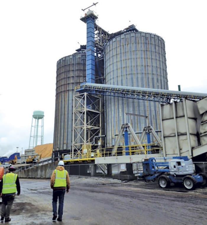

Image 1. When stored in a pile for a long time, wood chips sometimes heat and create hotspots leading to spontaneous combustion. In January, one of the energy plant’s silos caught fire because of a hotspot, and the smoldering started to heat a nearby silo full of wood chips. (Images courtesy of Atlas Copco)
