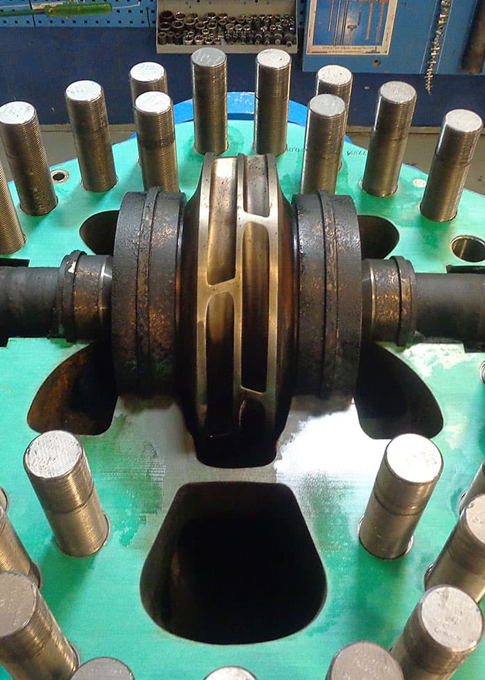

The key was the hydraulics, and designs were developed that modified the impeller and volute of the pump so that the specified flow rate and differential pressure could be achieved. Impeller and volute modifications also addressed concerns about vibration and cavitation at the increased flow rates.
The pump manufacturer developed a plan whereby one of the user’s spare pumps was reworked at the service center, thoroughly tested and shipped to site for installation in a live position. The pump that was removed was then shipped back to the manufacturer for the next hydraulic retrofit. This continued until all the rerates were installed.

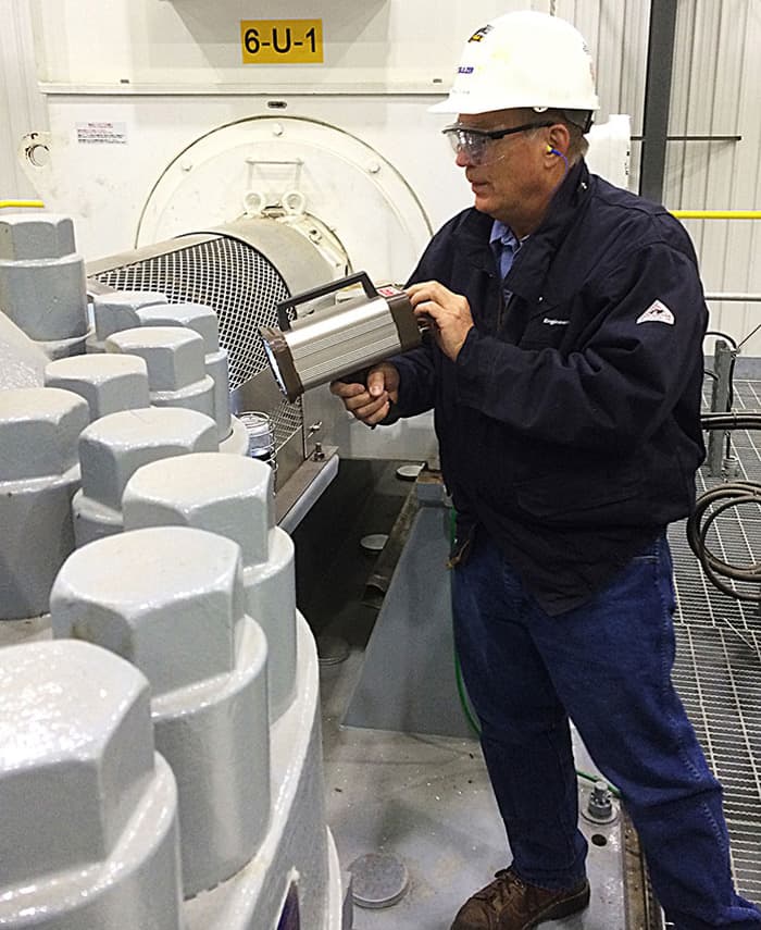

In the pump rerate example, field acceptance testing was provided in the form of a field performance evaluation. On three of the rerated pumps, actual field flow and pressure values along with vibration data and thermal images were all employed to confirm the pump rerate was performing as predicted and also provide baseline data for future trending.
