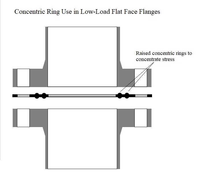

In addition, nonmetallic flanges must be flat face designs, as raised faces would create bending moments that could crack the brittle material. Full face gaskets have a much larger surface area compared to ring gaskets, so the compressive force generated is spread out over a much larger area, which results in much lower overall gasket stress. The gasket stress is reduced further due to the low allowable torque that must be followed to avoid compromising the structural integrity of the flanges.
IMAGE 1: Cross section of flange and gasket, demonstrating raised concentric rings to concentrate stress (Images courtesy of Garlock)

Compressive stress can be broken down into two components: the magnitude of the force and the area over which it is applied. As mentioned earlier, nonmetallic systems can be especially tricky, as flanges are often flat face, requiring a full-face gasket, which has a significant amount of surface area. Since the force is limited by the material properties of the flanges, it is necessary to look at reducing the contact area of the gasket to maximize the available stress.
One method would be to utilize stress concentration points on the gasket itself. This would reduce the contact area between the flange and the gasket to a much smaller size, allowing the force to be concentrated. Such stress concentration points can take a variety of forms, such as concentric rings that are molded into the gasket themselves. These would create strategic areas of stress concentration surrounding the inner diameter of the flange, preventing a leak path from connecting to the outer edge. Such a method would allow high-purity PTFE gaskets to be used in potable water and even the ultra-pure water applications found in the semiconductor and hydrogen industries. The limitation of this technique is that these gaskets require expensive molds, so the available sizes are limited to standard flange sizes that have existing molds.

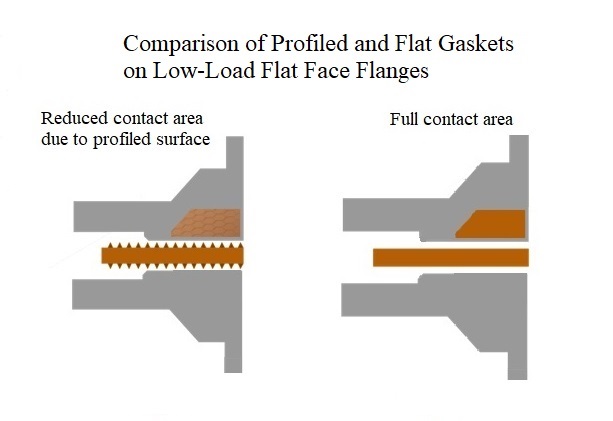

While a technique like this may be suitable for PVC or CPVC flanges, which are made to standard dimensions, there are often applications that need more flexibility. Nonstandard flanges or applications such as manway gaskets may require a solution that does not rely on having molds created for a specific size. Traditionally, gasket sheet material has been used since it can be cut to the exact dimensions required. To accommodate these applications, solutions such as profiled PTFE gasket sheet material can be used to harness the benefits of stress concentration points while retaining the ability to be cut to custom shapes. This is especially useful for FRP tanks or other manways with thin flanges that limit the amount of torque that can be applied.
IMAGE 2: Cross section of flanges showing the difference between an innovative profiled gasket and a traditional smooth gasket
Profiled PTFE gaskets offer other benefits as well. Concentrating stress in smaller peaks throughout the gasket allows for more even force distribution and avoids generating bending moments in the assembly. Conventional flat gaskets tend to concentrate the compressive force to the areas directly around the fasteners. Limiting the contact area increases the compressibility of the gasket, allowing the force to spread out more evenly. This also allows such a gasket to functionally seal worn out or pitted flanges that have an irregular sealing surface.
