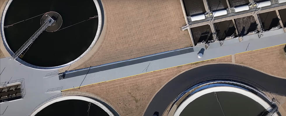

In primary treatment, wastewater enters a primary clarifier or sedimentation tank. There, the water is held so larger, heavier solids can settle at the bottom, while oil, grease and lighter solids rise to the surface. The settled material, known as primary sludge, is then removed from the tank using mechanical scrapers and pumps. Sometimes, this primary sludge is transported out of the facility for further treatment and reuse in various applications. Primary treatment removes only about 60% of the suspended solids from wastewater. Consequently, secondary treatment is necessary to eliminate biological matter and soluble materials that need oxygen to decompose, along with any remaining suspended solids. There are various methods for secondary treatment, with the activated sludge process being one of the most common.

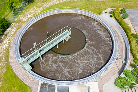

Activated sludge is a mixture of microorganisms and suspended solids that metabolize and break down organic contaminants in wastewater. The process begins with wastewater and primary sludge in an aeration basin, where air is injected to help break down organic matter. Once this biological treatment occurs, the sludge is settled out in a secondary clarifier. A portion of this settled biomass, designated as return activated sludge, is then pumped back into the aeration basin to maintain a healthy and active microbial population.
Without this step, levels of settled sludge will continue to rise, eventually leading to overflow of the clarifier and a disruption in the treatment process. Continuous flow is required to keep the microorganisms alive and maximize the efficiency of the process. The RAS pump, therefore, plays a vital role in sustaining the microbial balance necessary for effective treatment.

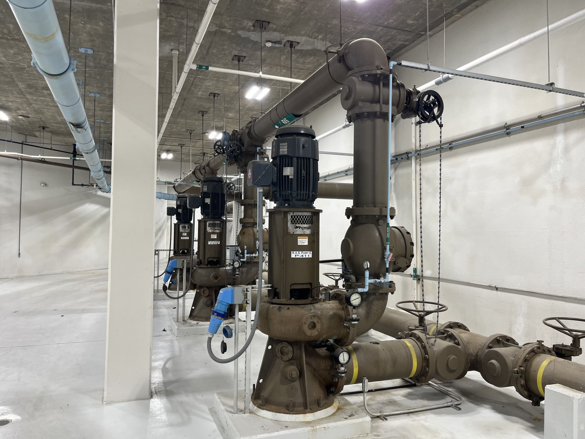

RAS pumps are unique in that they must move large volumes of sludge with high solids content while minimizing shear forces that could damage the biological floc. This requirement places specific demands on their mechanical design. Key features typically found in effective RAS pumps include large-passage impellers, often in a two-vane or recessed configuration, which allow the passage of fibrous and stringy materials without clogging. The impellers are usually precision-cast and designed to reduce turbulence and maintain smooth flow, preserving floc integrity. Pumps with thick-walled volutes and smooth internal passages help reduce wear from abrasive materials, extending the service life of components. Pump reliability is further enhanced by the use of heavy-duty bearings and sealing systems designed for long service life under demanding conditions.
High-strength, corrosion-resistant shafts, often with renewable stainless steel sleeves, are used to handle continuous operation while simplifying maintenance. Close-coupled vertical configurations are advantageous in space-constrained treatment facilities, offering compact design and easier alignment. Additionally, features like accessible packing boxes, clean-out ports and externally adjustable impellers facilitate regular maintenance and minimize downtime.
Modern control strategies such as variable frequency drives (VFDs) are frequently employed to modulate flow rates, ensuring optimal return sludge flow while minimizing energy consumption. Remote monitoring promotes preventive maintenance and allows operators to fine-tune performance in real time and respond swiftly to changing influent characteristics. These technical considerations are essential for maintaining stable biomass concentrations, avoiding upsets in biological treatment and complying with effluent quality standards.
Due to the requirement for continuous operation and often demanding conditions, redundancy and backup systems for RAS pumps are a necessity. Wastewater treatment plants cannot afford prolonged downtime, especially in the activated sludge process, where microbial stability is key. Designing systems with adequate redundancy ensures that maintenance or mechanical failure does not compromise effluent quality. This is especially important in northern climates, where extreme weather can exacerbate equipment stress and complicate repair logistics. Proactive asset management and life cycle planning are increasingly being adopted by municipalities to address these vulnerabilities and extend the operational lifespan of critical infrastructure.
