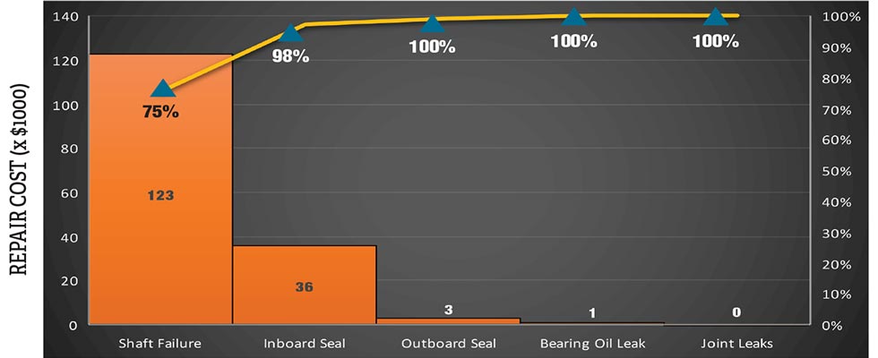

This month we will discuss the financial implications of a RCFA. We have all heard the expression “money talks.” Justifying an RCFA is no exception. When approaching management to suggest an RCFA, I would expect their response would be something along the lines of “How will this help our bottom line?” or, “How much money will it save us?”
Maintenance issues and associated costsIMAGE 1: Maintenance issues and associated costs (Image courtesy of the author). Based on a review of data, 75 percent of the repair costs were due to shaft failures which resulted in:

If you want to get management’s attention and cooperation, show them the financial implications of the system in question.
The financial analysis can be addressed with the support and assistance of your team, specifically:
  • Purchasing: History of purchases (items and cost) against the system
  • Operations: Downtime and the cost associated related to subject system
  • Maintenance: Issue and hours lost, plus the cost associated related to the system
The failures can be plotted on a histogram to demonstrate the frequency relative to the component, as well as the cost associated with the total number of failures over a specified time period as shown in the example in Image 1.
The benefits of showing the histogram and associated cost is that it helps people grasp the ideas—the graphic is simple to understand. You don’t have to be an engineer, or a certified public accountant (CPA) for that matter, to understand that this system is costing the company a great deal of money.
The next step: Drive home your point with a simple “show me the money” statement. For example:
“Between 1999 and 2002, there have been four pump shaft failures costing the company $2 million dollars in lost production and downtime.”
Management would have to be blind to not see the benefit of addressing this system by identifying the root cause and mitigating the failure mode(s).
