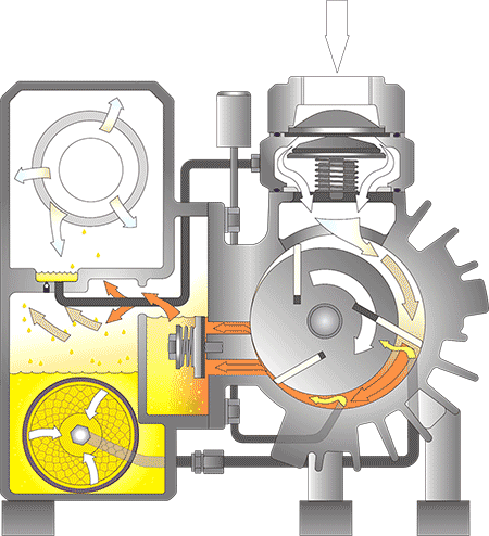

The Mechanics: How It Works
To understand how a rotary vane vacuum pump functions, it helps to picture its internal components:
- Cylindrical housing (stator): This is the stationary chamber inside which the pumping action occurs.
- Rotor: Offset from the center of the cylindrical housing, the rotor spins at high speed.
- Vaned blades: These typically slide freely in slots within the rotor, and they press outward against the housing walls due to centrifugal force.
- Inlet and outlet ports: These allow air or gas to enter and exit the pumping chamber.
Here is a simplified, step-by-step breakdown of what happens during one full rotation:
- As the rotor spins, the vanes extend outward, maintaining contact with the inner walls of the chamber.
- This action creates a series of variable-volume compartments between the rotor, the vanes and the stator.
- When a compartment aligns with the inlet port, it expands, drawing in gas from the application area (the vacuum chamber).
- As the rotor continues to spin, the compartment is sealed off from the inlet and its volume decreases.
- The trapped gas is compressed until it reaches the outlet port, where it is expelled against atmospheric pressure.
This process results in a steady suction at the inlet, creating and maintaining a vacuum in the connected system.

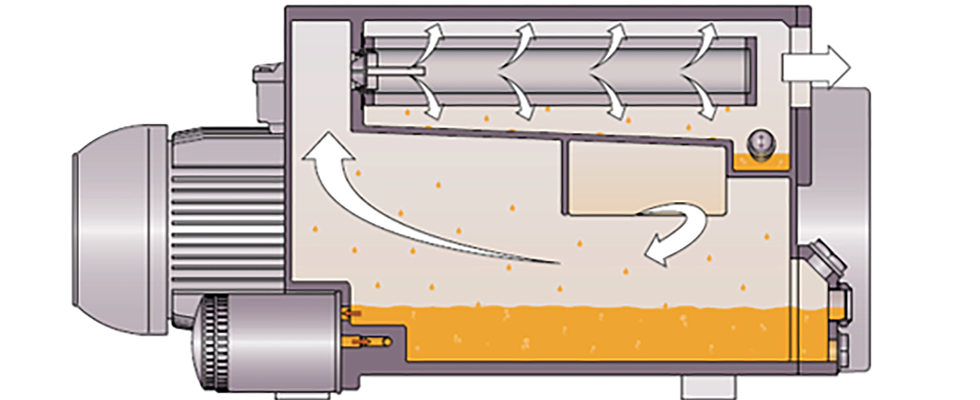

Oil-Sealed vs. Dry Rotary Vane Pumps
Rotary vane vacuum pumps come in two main types: oil-sealed and dry-running. Each has its own advantages.
Oil-Sealed Pumps
These are the most common type and are favored for their high vacuum performance and reliability. The oil serves several purposes:
- Lubrication: Reduces friction and wear on moving parts
- Sealing: Improves the airtightness of the rotor-chamber interface
- Cooling: Dissipates heat generated during compression
- Corrosion protection: The oil coats internal components, shielding them from reactive or corrosive gases that might otherwise cause damage to metal surfaces.
The downside is that oil needs regular maintenance and can become contaminated if the pumped gas contains reactive or particulate matter.
