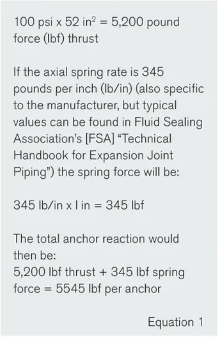

Pressure thrust
Pressure thrust sometimes surprises the installers, and it could be a rude surprise. Since a rubber joint has a flexible wall, when put under pressure it will inflate like a balloon. The fabric and reinforcing steel will restrain stretching in the radial direction, but there is no real restraint in the axial direction. The only axial restraints will be external in the form of either control rods or pipe anchors.
As a result, the axial restraints will be subject to a pressure thrust force in addition to the spring force of the rubber body. The total force on a pipe anchor will be the pressure thrust added to the spring force of the rubber body. For an expansion joint with control rods, the pressure thrust will be restrained by the control rods unless the joint is compressed.
In Equation 1, say the pipe and expansion joint are 6 inches in diameter, the operating pressure is 100 pounds per square inch (psi) and the thermal movement of the pipe is calculated at 1 inch. The pressure thrust from the expansion joint will be the pressure multiplied by the joint effective area. This example will use an effective area of 52 square inches (this is different for each manufacturer and can be found in the product literature).
The spring force may be obvious but the pressure thrust may not be. If the expansion joint is installed without restraints, the pressure thrust can easily move the connected pipe.
Another common installation has the expansion joint as a pump connector. For this installation, it is also common to include control rods to restrain the joint.
For this installation, no anchors would be required because the pressure thrust is restrained by the control rods. If the same parameters are being used as the anchored pipe example, the control rods would be restraining the 5,200 lbf pressure thrust with no thermal movement.

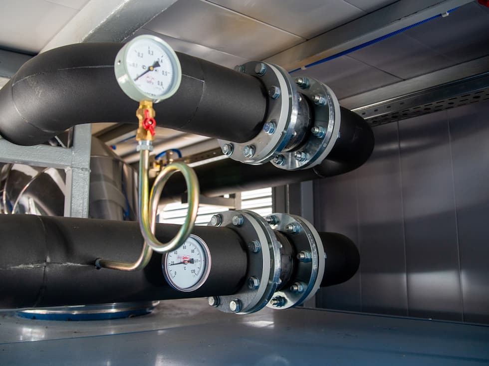

Expansion joint failures are routinely traced back to installation problems. Here are some of the more common installation issues:
  • The expansion joint was used to make up for a pipe misalignment. The nature of a flexible joint makes it tempting to use to compensate for a pipe misalignment. Do not do this. If a joint is used to make up for misaligned pipe, some of the rated movement will be taken up by the misalignment. At this point, the joint can be easily overextended.
  • No anchors or control rods installed. This unfortunate situation will usually result in the joint overextending itself under pressure. As described above, a lack of restraints will allow the joint to extend beyond its movement limits.
  • The expansion joint was not installed at the proper face-to-face length. This is similar to the joint making up for a pipe misalignment, except the pipes may be aligned, but the space between the flanges is either too short or too wide to install the joint in a neutral position. Many times, the joint is crammed between two flanges that are too close together. This can damage the bead of spherical joints, resulting in seal failure.
  • Loose bolts. Nearly every installation visited has had loose bolts, loose enough to finger-tighten. Be sure to follow the manufacturer’s recommendations for bolt torque and retightening schedules.
