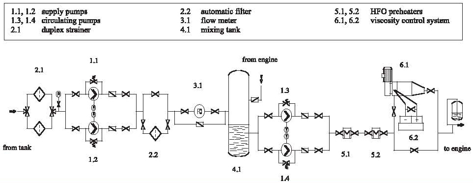

 Figure 2. Hydraulic scheme of a booster module
Fuel temperatures can reach 150 C, so the fuel must be pressurized by supply pumps to avoid evaporation of residual water and low volatile components. To stabilize the control loop, the heated oil is circulated between the booster module and the engine. The rate of the circulated flow is larger than the maximum consumption of the engines. A twin set of screw pumps is commonly used for the supply unit and the circulation loop. Because a breakdown of the booster module will stop the vessel, a redundant pump is available. A defect in one pump will affect the continued operation. Recent, frequent failures prompted a detailed investigation.
