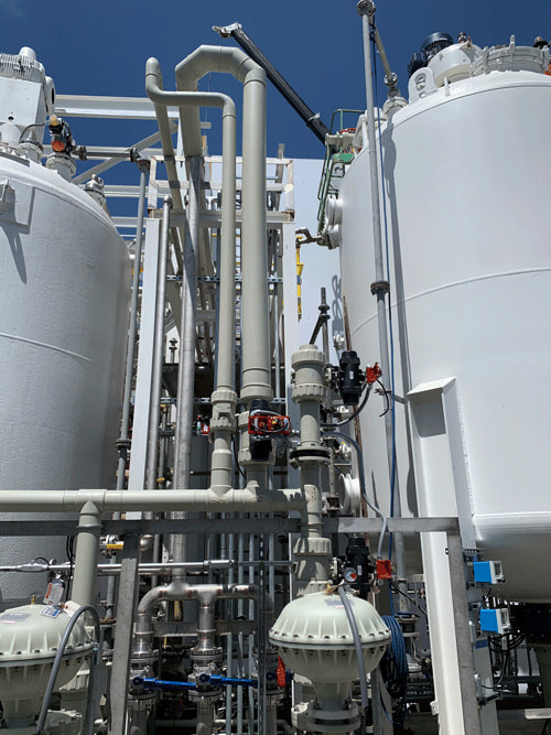

IMAGE 2: Glass-filled polyamide pneumatic actuators automating Type-21 ball valves in a lithium nickel slurry application.
