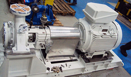

image 1 center line pumpIMAGE 1: A centerline-mounted, back pull-out, single-stage process pump (Image courtesy of Hydro Inc.)
The emphasis of the API 610 pump standard is on strength, quality and reliability. API pumps are centerline-mounted (Image 1) and the stipulated distance between driver and driven shaft ends is 7 inches. Spacer couplings keep misalignment angles low and greatly facilitate back pull-out of hydraulic assemblies in need of exchange or repair.
