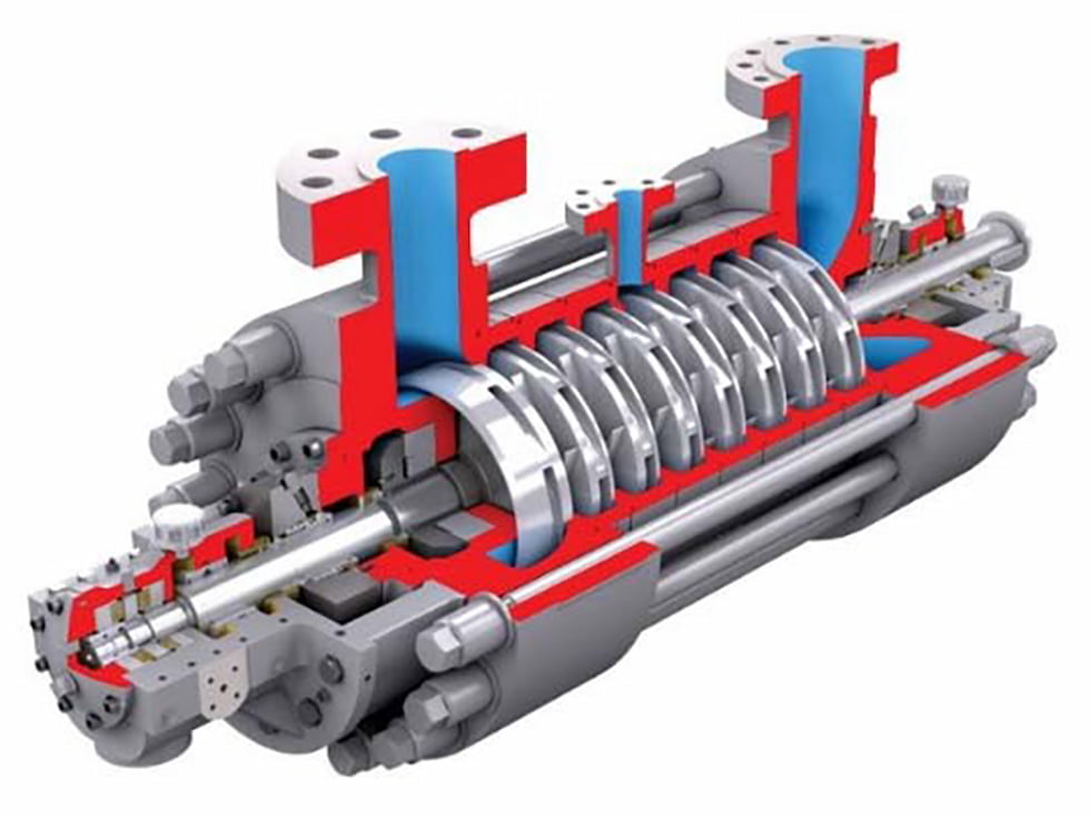

image 1 diffuser ringIMAGE 1: Diffuser ring-section pump (Images courtesy of Flowserve)

Main Feedwater Pumps
The purpose of a main feed pump is to deliver feedwater from the low-pressure (LP) drum to the economizer inlets of the intermediate-pressure (IP) and high-pressure (HP) sections of the heat recovery steam generator (HRSG).
Multistage, inline diffuser, ring-section pumps are most typically specified for this service in combined-cycle plants.
Occasionally, customers will specify a double-case design for these applications.
Boiler feedwater is chemically treated to a high purity level, making it more corrosive than untreated water. As a result, the fluid-handling components (e.g., stage casings, diffusers and impellers) that see high fluid velocities must be provided in 12 percent chrome (CA6NMN) to avoid erosion-corrosion damage.
On higher-pressure applications, the suction and discharge heads are also recommended to be in 12 percent chrome. Laser hardening or direct laser deposition (DLD) at running fits can be offered to make the pump resilient to damage that may be caused by transient operation, including loss of suction pressure. The laser-hardening treatment only hardens the outer surface of the part; the base material remains unchanged.
image 3 and image 4IMAGE 3 (left): Condensate pump with a single-suction, first-stage impeller.
IMAGE 4 (right): Double-suction, first-stage condensate pump
The result is a reliable, ductile part, with maximized surface hardness, which is the ideal blend of part characteristics. DLD is a welding process that metallurgically bonds a metal powder to the base material. Due to a controlled and localized heat input, this process can be applied to various base metals without distortion or the need for post-weld heat treatment.
Suction performance, while important for all pumps, is a concern for high-energy pumps in boiler feed service.
The net positive suction head available (NPSHa) is limited by the physical height of the suction vessel, but certain NPSHa and NPSH required (NPSHr) margin ratios must be maintained to achieve optimum performance and long life. The first-stage impeller is selected with particular care and often features a larger suction eye or, in some cases, a double-suction design.
The pumps offer an intermediate takeoff connection to provide flow to the IP section of the HRSG. Boiler feed pumps are subject to sudden load swings and operation at numerous operating conditions. As a result, the typical bearing arrangement is sleeve radial bearings and tilting pad-type thrust bearings on applications exceeding 4,000 horsepower (hp).
With this type of arrangement, a forced feed lubrication system is used. On lower hp applications, other bearing arrangements may be considered.
Feed pumps may be direct drive or variable speed drive with the use of fluid couplings or variable frequency drives (VFDs).
The most common configuration is 2 x 100 percent per HRSG.
