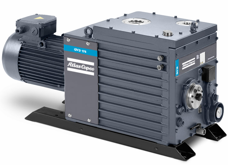

Two-stage, oil-sealed rotary vane pumpIMAGE 1: Two-stage, oil-sealed rotary vane pump (Image courtesy of Atlas Copco)
The target is a solvent-free extract. Therefore, the ethanol used in the extraction needs to be removed. Ethanol boils away at around 78 C (172.4 F) at atmospheric pressure. However, if users can pull a vacuum deeper than about 28.5 inches Hg gauge (HgV), the ethanol’s boiling point is reduced to 12.8 C (55 F), which is well below room temperature.

Should this lead lab owners to purchase an oil-free vacuum pump? For some applications, yes—but it is far from always necessary. While the optimal choice will depend on the specific application of the pump, most CBD/THC applications employ oil-sealed rotary vane pumps. When oil-lubricated pumps are employed, it is important that they be properly maintained at the manufacturer’s suggested service intervals and to ensure that the oil is changed as needed depending on the environment the pump is being used in.
Looking at the market, rotary vane or liquid ring pumps are typically employed for cannabis distillation. Typically, these high-performance pump types are capable of maintaining the vacuum depth required, and they allow users to flush the vacuum pump to maintain the precise base pressure over time. Further, these are usually among the lower-priced pump options, providing high-value options for operators. Scroll pumps work well for purging vacuum ovens to collect the terpenes produced during distillation.
