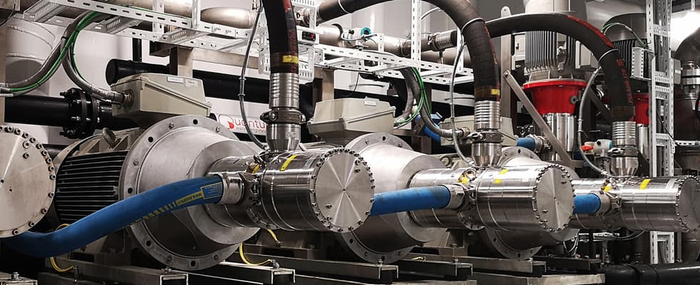

Parallel coupled high-pressure AP pumps and ERDs installed on a limited-space well-boat

A Spain-based engineering company specializing in reverse osmosis water treatment solutions was building a seawater reverse osmosis (SWRO) system for a large well-boat in Norway that needed to delouse salmon with freshwater treatments. There were three primary requirements for the desalination plant:
  1. Provide 5,000 m3 per day while maximizing the boat’s limited space.
  2. Ensure the highest energy efficiency to maximize their users’ return on investment.
  3. Ensure the best equipment availability, quick maintenance and system reliability to mitigate the risks of sea lice infestation and amoebic gill disease.
To meet these challenges, the company designed a two-train SWRO plant. Each 2,500 m3 train is equipped with two parallel installed high-pressure axial piston pumps and two parallel installed active isobaric ERDs, each connected to a VFD.
These components are particularly well suited for uptime requirements and situations where space is limited. The ultra-compact design of the AP pumps allows for on-site maintenance, while the active ERDs’ three-in-one design combines an isobaric pressure exchanger, booster pump and motor for extremely compact energy recovery.
The general manager of the company highlighted that the combination of AP pumps and active ERDs was crucial in meeting the client’s goals for the desalination plant. This solution offers reliable, low-energy consumption with minimal maintenance, and delivers high production capacity in a compact design.
