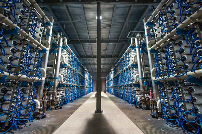

Carlsbad Desalination PlantImage 1. High-pressure seawater is pressed through millions of square feet of spiral-wound reverse-osmosis membranes at the Carlsbad Desalination Plant in Southern California. (Image courtesy of Poseidon Water)
