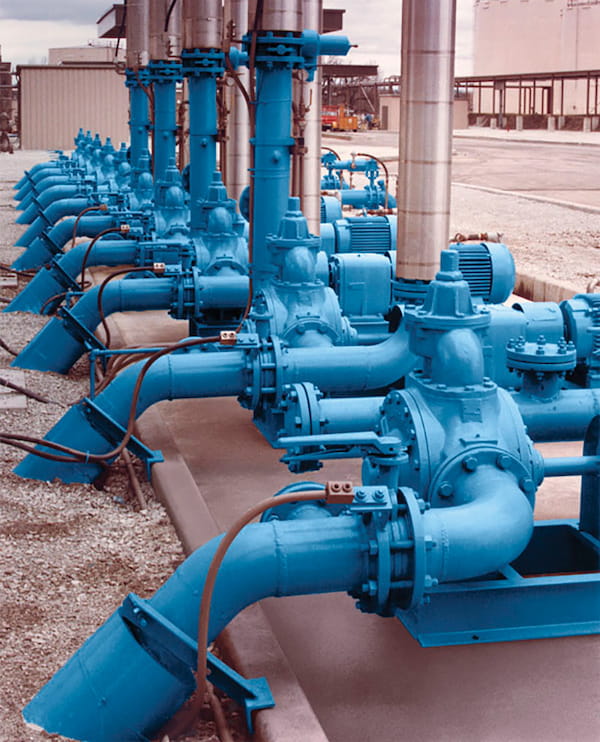

For more than a century, sliding vane pump technology has provided reliable performance in a myriad of refined fuels transfer operations. The secret to the sliding vane pump's repeated success is found in its unique design and method of operation. Sliding vane pumps have a number of vanes that are free to slide into or out of slots in the pump rotor. When the pump driver turns the rotor, a combination of forces (centrifugal, mechanical push rods and liquid) causes the vanes to move outward in their slots and around the inner bore of the pump casing. This forms internal pumping chambers. As the rotor revolves, the fluid flows through the suction port and into the pumping chambers created by the vanes. The fluid is then transported around the pump casing until reaching the discharge port, at which point the fluid moves into the discharge piping. This design enables the sliding vane pump to deliver operational characteristics necessary for effective fluid transfer in oilfield production and supply, as well as refined fuels transfer applications. Specifically, those characteristics are:- high suction capability
- line stripping
- dry-run capability
- self-priming operation
- volumetric consistency
- non-slip operation
- non-galling
- superior product sealing
- high or low flow rates
- easy maintenance
- stationary, skid or truck mounting
- stainless-steel, ductile-iron or cast-iron construction
