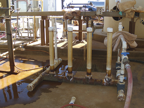

At every concentration tank, a sump collects a combination of process water and rainwater. Most of the process water comes from washing of the socks—large, fine-mesh cotton bags that are installed on transfer hoses to filter sand, mud and other grit from the solution before and after it is pumped into the injection wells (see Image 4, page 44). The water in the sumps—loaded with debris from the socks and surrounding soil—must be pumped to a wastewater system in which any solids are filtered out before the water is transported to a deep disposal well for reclamation.

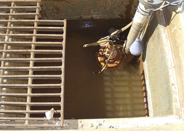

The semi-open impeller constructed of 28 percent chrome works with the agitator to easily pass aggregate through the pump and out the discharge. The agitator keeps solids suspended in the fluid being pumped so that the entry remains clear and pumping action continues without fail.
The top discharge, slim-line design of this agitator pump ensures optimum wear resistance along the discharge path. Further, the pumped fluid cools the pump’s internal motor functions as it passes. The vertical design allows for the sump to be pumped down to within inches of the bottom (see Image 5).
The pumps have run reliably since their installation, resisting the grit and keeping up with the demand even during heavy rainstorms. By early 2012, the company was using four of these pumps at the facility and specified this model as the standard pump for the sumps in its operations.
