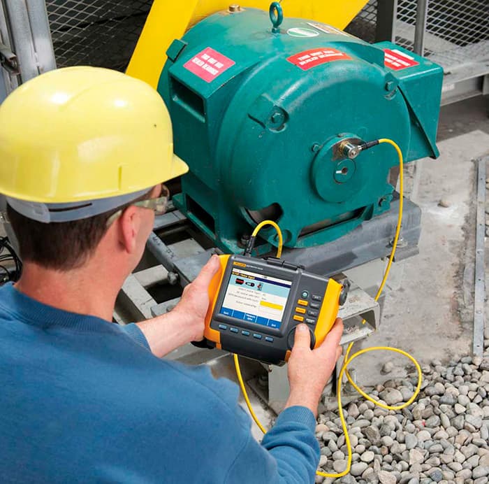

These smart tools do not replace the analyzer or the experienced analyst, but they do allow maintenance technicians to effectively screen machines, which frees up the experts to focus on more complex and critical machines. These new tools allow maintenance teams to cover more machines with the same or fewer resources. Typically, 80 to 90 percent of machines are standard and are well-suited for vibration testers and meters. Another advantage of these tools is that they are a good fit for today’s maintenance technicians, who often are accustomed to using their smartphones to search for answers on the web or from others. These individuals do not have time to analyze reams of data. Instead, they need immediate answers to keep the plant up and running. Because many of these newer vibration tools can save data to a smartphone and secure data centers where the data can then be stored and shared, technicians can reach out to experts when needed to get valuable advice on next steps in troubleshooting or repairs. This capability provides a clear path toward proactive maintenance without requiring companies to expend a tremendous amount of resources..jpg)
