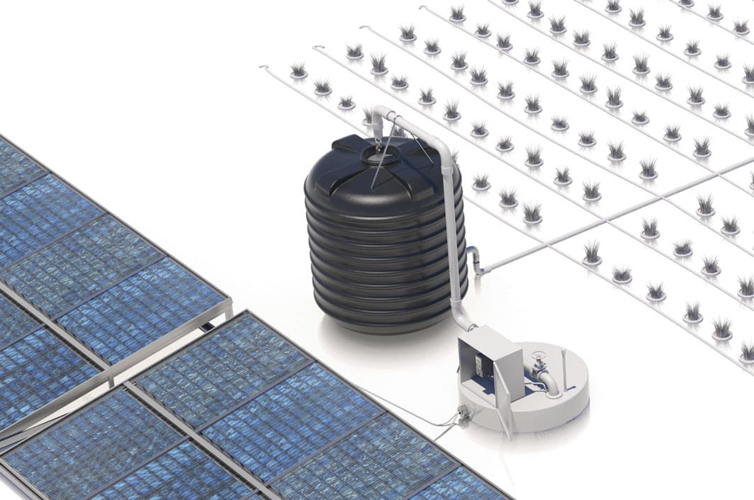

One solar pumping solution combines drive technology with solar panels and a maximum power point tracking system (MPPT). The MPPT controls the pump as a function of solar radiation. Rural pump operators, such as farmers, can benefit from the maximum amount of pump output during the day. The solar pump drive is independent from the grid and produces no pollution or noise.
The complete system consists of four components: photovoltaic (PV) cell, drive, motor and pump. The PV cell links to direct current (DC) connectors on the solar pump drive. The drive is connected to the motor that runs the pump.
The wide power and voltage range enables operators to use solar pump drives for a longer time. Larger applications, such as high-power pumps in agriculture, water supply and desalination, can depend on the drives' consistent performance.
