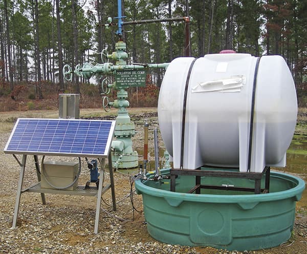

The Solution
Diaphragm metering pumps are highly durable and resistant to different chemicals. Therefore, they are an effective solution for oilfield chemical injection. Featuring few moving parts and no dynamic seals, diaphragm metering pumps are reliable and easy to maintain. The diaphragm completely separates the chemical side from the hydraulic-fluid side. Regardless of the chemical to be injected, the seal materials do not require changeout. On the hydraulic-fluid side, no O-rings are used in the pressurizing piston sleeve, which means less wear on the piston rod. The components that contact the injected chemical—such as the pump head and check valves—are stainless steel, and the diaphragm is constructed of a chemical-resistant polytetrafluoroethylene-coated diaphragm. This design helps extend pump life, prevent chemical leaks and reduce the cost of maintenance. A top monthly operational expense incurred by many oil and gas producers is the cost of chemicals for injection into the wellbore. Frequently, chemical injection pumps will be set at a higher dosing rate than required for the well. This practice counteracts inherent or perceived pump inefficiencies. Diaphragm metering pumps address this concern by consistently injecting user-selected chemical volumes into the wellbore with extreme accuracy..jpg)
Conclusion
The solar-powered diaphragm chemical-injection system offers benefits previously unavailable to unconventional oil and gas producers:- Environmentally friendly, emitting no atmospheric gases
- Sealless, low-maintenance diaphragm metering pump technology
- Consistent injection of accurate user-selected chemical volumes, enabling less chemical consumption, lower costs and predictable downhole benefits
