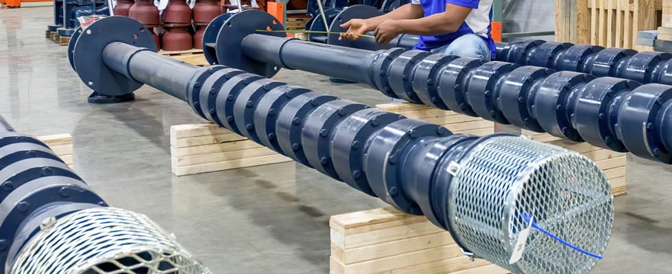

IMAGE 1: When products, packaging or literature are marked as certified, this covers the manufacturing facility and the product. (Images courtesy of Franklin Electric)
