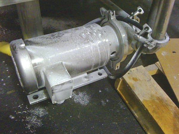

Epoxy encapsulated stainless steel pump washdown motor (Courtesy of Baldor Electric Company)Epoxy encapsulated stainless steel pump washdown motor (Courtesy of Baldor Electric Company)
