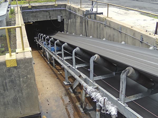

When the raw petcoke is transported to PABTEX’s terminal in bottom dump railcars, a system of shakers breaks the petcoke into smaller chunks that are easier to transport on a conveyer system. Below the shakers is the open conveyer shaft that is 70 to 80 feet below the ground.
Because rainwater often fills the conveyer shaft, a large sump was sunk into the bottom of the shaft to ensure that water could be pumped into an existing retention pond. With the shakers directly above the bottom of the conveyer shaft, pieces of petroleum coke fall into the shaft and eventually wash into the sump.
Todd Wilkes, the maintenance supervisor of Savage Gulf Services, which operates PABTEX’s Port Arthur terminal, had tried several submersible pumps in the conveyer shaft sump. However, coke is similar to coal fines when pumped—very abrasive and easily separates into a slurry. Because most submersible pumps are cast iron, they cannot hold up in this demanding service. Petcoke is too abrasive, and without an integral agitator, solids settle-out and clog the pump.

Saladin Pump installed a 10-horsepower, submersible slurry pump in the sump at Salvage Gulf Service for a 60-day trial. The trial was successful with no clogs or wearing issues. Savage Gulf bought the pump, and 60 days later bought a backup pump. Pumping reliability is critical to the overall refining process.
