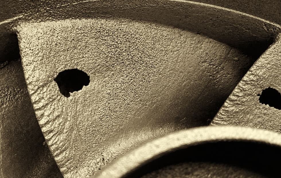

NPSH is particularly important to dynamic pumps such as centrifugal pumps. These pumps are vulnerable to cavitation. If cavitation occurs, the drag and friction in impeller vanes increase drastically, seriously restricting the flow and interrupting the operation. Cavitation has many adverse effects on impellers and generally on pumps. Prolonged exposure to cavitation can damage the impellers. NPSH refers to two quantities:

When a liquid enters the eye of a pump impeller, it accelerates as it is drawn into the impeller. This acceleration creates a pressure drop in the liquid at the impeller eye. If the liquid is close to its boiling point (bubble point), the pressure drop may be great enough to cause some of the liquid to boil. The bubbles that are formed by the boiling liquid enter the pump impeller along with the liquid. As the liquid (and bubbles) flow toward the tip of the impeller, the pressure rises and the bubbles collapse or implode. When these bubbles collapse, a large amount of energy is transferred from the fluid to the impeller at a very small point on the impeller. This energy is sometimes great enough to damage the impeller and is frequently enough to cause vibration and noisy pump operation. This process is called cavitation, and it must be avoided in the operation of any pump.
The damage caused by cavitation depends on several factors such as pump speed, impeller material, amount of cavitation, type of liquid, etc. The type of liquid is particularly important. For example, cavitation in water pumps is usually more serious than in hydrocarbon pumps. This is because water has a much higher latent heat of vaporization than hydrocarbons (say, three to eight times higher). As a result, when the bubbles collapse, far more energy is released causing more damage to the impeller.
Cavitation can be prevented by making sure that the pressure at the suction of the pump is sufficiently above the bubble-point of the liquid to prevent the liquid from boiling as it enters the impeller eye. Pump manufacturers publish NPSHr values for their pumps. It should be ensured that NPSHa is greater than NPSHr at all times.
