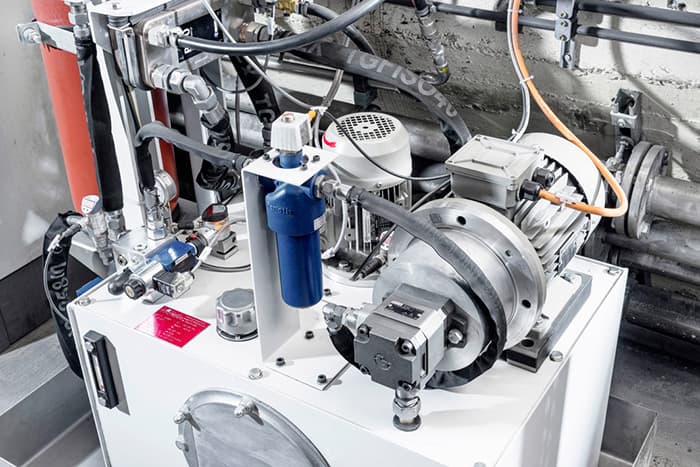

Image 1. A refit and customized hydraulic system (Images courtesy of Bosch Rexroth Corporation)
This changing landscape of hydraulic drives pushes fluid power specialists to quickly adapt to using VSDs. For many engineers, this is not easy. Optimum use of VSDs often requires additional considerations and modifications to a system design. Fluid power engineers must understand the distinctive features of VFDs and the requirements of the production process to define the critical points for the electric and hydraulic elements. The goal of the system is to meet the requirements of dynamics and accuracy while maintaining overall energy efficiency. When applying a VFD-driven pump, using a conventional induction motor or a permanent magnet servo motor (PMM), dynamic behavior will differ from a system using a constant speed drive and throttling control valve.

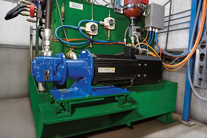

Image 2.  A core shooter at a foundryImage 2. A core shooter at a foundry
