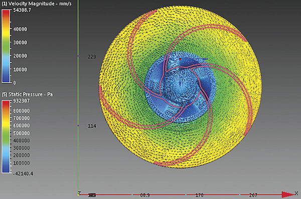

pressure contours/velocity vectorsFigure 1. The pressure contours/velocity vectors in an impeller (Courtesy of IPC)

The introduction of computational fluid dynamics (CFD) also influenced the development of the process pump industry. The hydraulic design of pump flow patterns using 3-D shapes is a delicate task. Increasing computational power and the availability of reliable codes allowed consistent improvements to the centrifugal pump design process and the integration of original equipment manufacturer (OEM) experience with reliable simulations and predictions. Modern CFD commercial codes have advanced capabilities for modeling viscid and inviscid fluids. They also offer several turbulence equations and non-stationary algorithms for turbomachinery rotating regions.
The full design loop still needs to be closed with final machine physical testing at OEM workshops, but the implementation of CFD methods leads to better designs and shorter turnaround times. The computer simulation allows OEMs to quickly develop hydraulic channel shapes optimized for specific goals (such as max efficiency or NPSHR) in the operative conditions specified by the end user. The importance of these advancements became even more evident in light of the possibility of manufacturing customized hydraulic parts obtained from CFD design by integration with modern computer-aided design or computer-aided manufacturing (CAD/CAM) technology.
