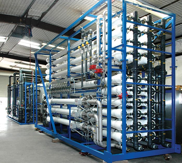

A Texas-based refinery represented an example of an industrial facility in need of water infrastructure upgrades. In December 2015, the company decided to update an aging ion exchange system, which had become inefficient and costly to maintain. Waste from the system was generated every two days, and chemical and treatment costs were high. The plant desired higher-quality water to feed the high-pressure boilers, and the system upgrade had to comply with strict suspended and dissolved solids quality requirements for boiler feedwater in Texas.
Image 1. A 750-gallon-per-minute wastewater treatment system with fully automated controls operates at a facility in McKinney, Texas.Image 1. A 750-gallon-per-minute wastewater treatment system with fully automated controls operates at a facility in McKinney, Texas. (Courtesy of Progressive Water Treatment)

To address these key concerns, the refinery outsourced its new boiler feed system to a Texas-based water services company. The company replaced the outdated system with a reverse osmosis technology designed and engineered to comply with regulations, reduce chemical costs and require little to no maintenance.
Engineering Challenges
With on-site space constraints, engineers were brought in to design and install a safe and user-friendly water treatment system at the refinery. In order to use a small area in the heart of the facility, the engineering team designed the system so that three complete 250-gallon-per-minute reverse osmosis units could be mounted on one 37-foot-by-39-foot painted steel skid.
The company creatively engineered a system that would reuse 100 percent of the water on-site, with the option of utilizing the reverse osmosis reject water as feed for the cooling towers and the reverse osmosis product as boiler feedwater, to improve efficiency and reduce costs.
The new treatment system included multimedia filters, water softeners and single-pass reverse osmosis with required chemical treatment systems. Some existing equipment, such as tanks and chemical pumps, were used in the overall plant scheme to further save
on capital cost.
The improved system included a program logic controller and human machine interface for completely automated controls. The new system was easy to access for any necessary repairs, used little space at the facility and required little manpower to operate, further reducing maintenance and operational costs.
Refinery Refresh
The water services company designed and built a custom system that combined all three units onto one common frame. This enabled it to fit in a non-hazardous location of the plant, saving on capital costs for a new building as well as associated engineering and design labor.
The company employed a team of creative engineers that were able to design and locate the system in an ideal part of the plant. With limited options, the system could have been located in a hazardous area of the facility, and equipment costs could have soared to two to three times the refinery’s capital costs for the project.
Installed in December 2015, the system is projected to reduce supply costs, improve operating efficiency, decrease maintenance costs and provide a consistent, quality boiler feedwater supply at the refinery.
