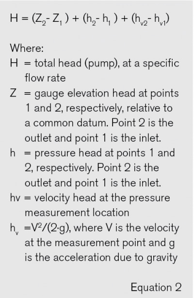

The pump curve or total head of the pump as a function of flow rate is measured much like the total head of the system but points 1 and 2 will be on the inlet and outlet of the pump, respectively. Image 4 shows pump pressure instruments referenced to a common datum and the direction of flow is indicated by arrows. The total head of the pump is the difference between the total discharge head (point 2) and the total suction head (point 1). The term “total” indicates that it includes the static pressure head (h), the velocity head (hv), and the elevation head (Z).
The equation for total head (pump) can be expressed in Equation 2.
To measure the total head of the pump, pressure will be measured at points 1 and 2, the elevation from the pressure gauge to datum will be measured, and the velocity at the pressure measurement location will be calculated based on the volumetric flow rate and the pipe inside diameter. The pressure measured will need to be converted to feet of liquid based on Equation 3.

equation 2
