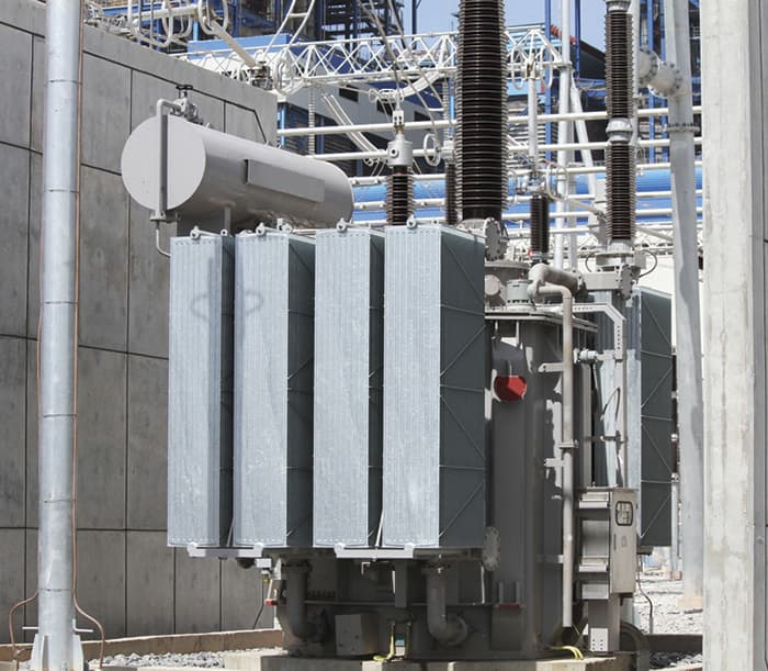

Image 1. Plants utilize distributed power technologies to ensure a robust energy supply and increase productivity. (Image and graphics courtesy of Badger Meter)Need for Effective Cooling
Plants use distributed power technologies to ensure a robust energy supply and increase productivity. However, heat generated by electronic devices and circuitry must be dissipated to improve reliability and prevent premature failure. Traditional techniques for heat dissipation include heat sinks and fans, as well as other forms of automated cooling such as liquid cooling. Hydronic cooling (i.e., the use of water as a heat-transfer medium) is commonly employed to keep plant power systems within the proper temperature range. Water has a high thermal conductivity, meaning it absorbs heat easily—more so than air. It is effective for cooling power supply equipment. Water cooling transfers heat from each part to a radiator that dissipates the heat and cools the liquid—similar to a car’s radiator. In any hydronic cooling application, the liquid medium must flow at designed flow rates within the system. It is also important to assess load variations. Load is calculated by using the flow rate as well as the associated supply and return fluid temperatures. Hydronic cooling systems can be difficult to balance because of the presence of multiple system branches, changes in cooling demand, and pressure differences among the various supply and return lines. Inclusion of balancing valves and flow meters at each terminal or branch circuit facilitates balancing. To help reduce the cooling system’s energy requirements, system designers also seek to minimize the cooling system pressure drop. Measuring the bidirectional flow of liquid circulating in the hydronic system is critical in order to monitor proper cooling performance. Flow measurement instruments are used to detect reduced flow rates, leakage and other conditions affecting the robustness of cooling equipment.Selecting the Right Flow Meter
