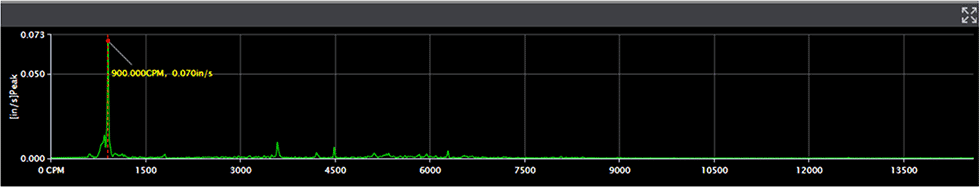

The equipment at the center of the first case is a vertically mounted pump-motor system at an industrial facility in a cold climate region. The subject system had not been exhibiting overt performance issues but was enrolled in a continuous monitoring program to track baseline behavior and detect potential failure trends over time. Information collected included velocity and spectrum data from motor, pump and recirculation line sensors at regular intervals over multiple seasons.

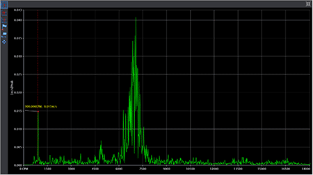

Although vibration amplitudes remained below alarm thresholds, a consistent seasonal increase was detected in motor vibration amplitudes—up to 150%-200% higher from November through April. These trends were subtle, repeatable and pointed to environmental factors. Frequency analysis revealed a discrete peak at 900 cycles per minute (CPM) and intermittent excitation in the 3,600-7,750 CPM range. These were linked to transient cavitation events and turbulence in the system, particularly on the pump and recirculation line.
Rather than trigger alarms or unnecessary shutdowns, the condition monitoring platform enabled a deeper analysis of the machine’s behavior under environmental stress. Cavitation and turbulence issues were flagged as intermittent and seasonal, not constant. Further inspection was recommended to rule out sensor mounting issues, and the maintenance team planned a coupling inspection at the next outage.
By having continuous monitoring data available, the end user was able to not only identify an intermittent issue that may have been missed using route-based methods but also to quickly perform an in-depth risk assessment that circumvented an unnecessary shutdown.

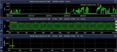

Analysis of the blower’s vibration data revealed significant anomalies. In Image 3, the trend (top graph) indicated a gradual and then sudden increase in vibration levels beginning around March 2025, peaking at 0.479 inches per second (in/s)—well above typical operational baselines. The waveform (middle graph) showed a consistent, repeating oscillation pattern, indicating mechanical looseness or surface degradation rather than random impacts. The spectrum (bottom graph) confirmed this diagnosis, with a strong peak at or near 1X running speed, characteristic of rotating element wear without significant harmonics or sidebands.

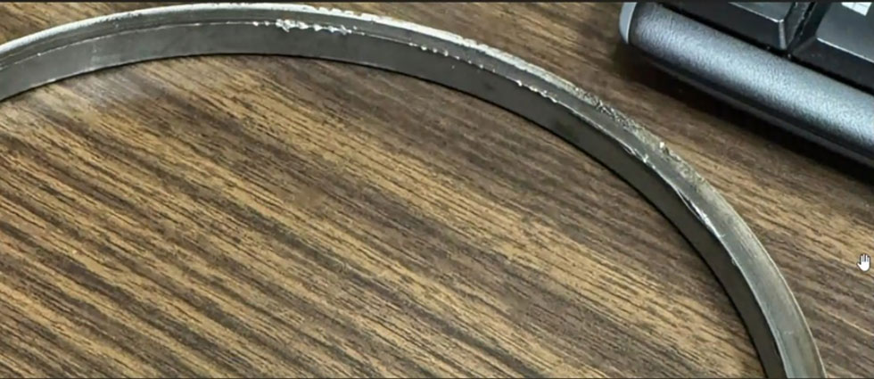

Upon inspection, physical evidence confirmed the diagnosis: Heavy wear and spalling were visible on the inboard bearing’s raceway (Image 4). The damage likely resulted from prolonged metal-on-metal contact due to lubrication degradation or normal fatigue wear.
