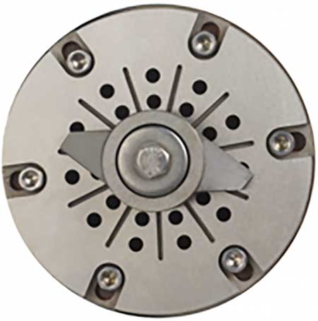

Grinder pumps are the most common choice in traditional pressure sewer applications where raw wastewater—including solids, fats, oils and grease—must be conveyed. These pumps grind solids into a fine slurry, making it easier to transport through small-diameter force mains. There are two main types of grinder pumps: progressing cavity (PC) and centrifugal.
PC grinders operate at low speeds (typically 1,750 rotations per minute [rpm]) and can handle high heads at an average flow of 11 gallons per minute (gpm). They are well suited for residential installations where high head capacities are required. However, due to their limited flow capacity, commercial applications may require multiple pumps and larger basins to accommodate higher demands.
Centrifugal grinders run at higher speeds (around 3,450 rpm) and provide greater flow, helping to maintain scouring velocities that prevent solids from settling in the pipe. Their higher throughput and better solids handling make them a good option for both residential and commercial applications.

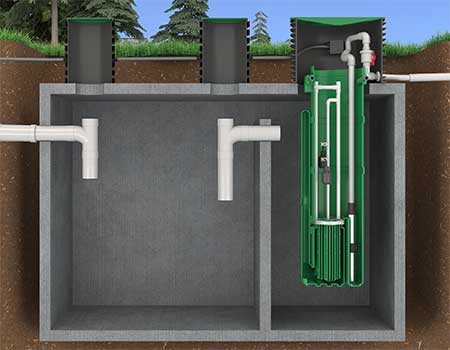

Grinder pumps are typically installed in outdoor lift stations. These stations commonly use either a flexible discharge hose or a rail system for pump removal. Rail systems are generally recommended, as they simplify pump maintenance and allow for easier removal and reinstallation of the unit.
Turbine pumps, by contrast, convey filtered effluent from septic tanks or pretreatment units. Solids remain and are treated on-site, which reduces the waste strength reaching downstream treatment facilities. Because the collection network carries mostly liquid, concerns like scouring velocity and solids buildup are minimized, allowing for greater flexibility in pipe sizing and system layout. These pumps may be installed in separate pump tanks or directly inside the septic tank, but in either case, a filtering mechanism is required to protect the pump.

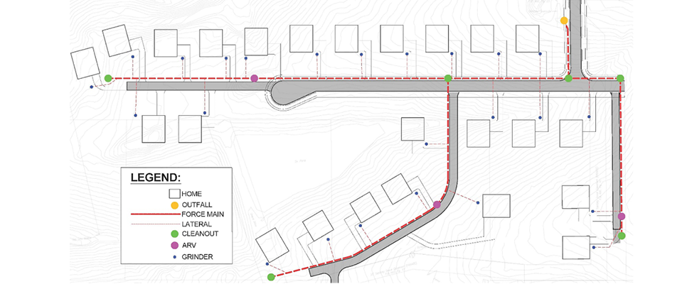

Combination air release/anti-siphon valves are installed at high points in the force main to eliminate trapped air that restricts flow. These valves also prevent unwanted siphoning of pump vaults, which can lead to nuisance alarms or pump failure.
Flush connections are another essential feature. Terminal flush points should be installed at the end of each force main, and additional connections should be added at changes in direction, at intersections and roughly every 1,000 feet in long straight runs. These access points allow utility crews to clean out the lines and remove buildup, keeping the system flowing smoothly.

Accurate design begins with hydraulic modeling. Engineers typically choose between two methods to estimate flow and size the force main: the probability method or the rational method.
The probability method is tailored for systems with PC grinder pumps. It estimates how many pumps are likely to run at the same time and calculates system flow accordingly. This method is useful in neighborhoods with uniform residential use but becomes less reliable when commercial facilities are involved.
In contrast, the rational method calculates peak system flow using the equation Q=AN+B, where A is typically 0.5, N is the number of equivalent dwelling units (EDUs) and B is typically 20 gpm but can be adjusted, provided it does not exceed the maximum flow capacity of a single pump. This method is suitable for both centrifugal and PC pump systems and allows designers to easily account for mixed use developments by converting nonresidential flow into EDU equivalents.
