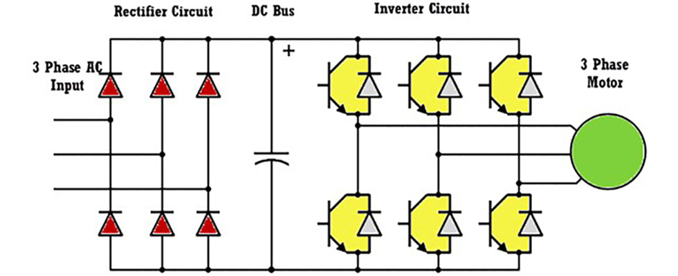

VFDs control motor speed by first converting alternating current (AC) power waveforms into direct current (DC) power and back to a variable frequency AC waveform through various power electronic components. Most harmonic distortion is generated during the AC to DC conversion stage. As the application load increases, so does the significance in harmonic distortion.

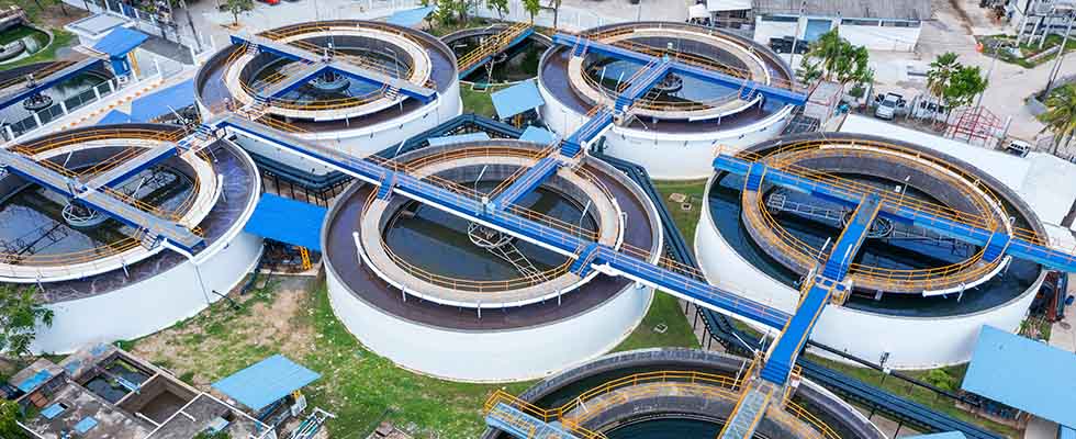

In wastewater treatment facilities and municipal water systems where pumps, blowers and process equipment operate continuously, the long-term effects of harmonic distortion become especially consequential. In remote agricultural installations, where power is frequently delivered over long feeder lines and may already be subject to voltage irregularities, power quality concerns are amplified. The addition of nonlinear loads such as VFDs can create further risks to system performance unless harmonics are properly managed.

In agricultural irrigation systems, harmonic mitigation is often needed to protect equipment powered by long feeder runs or undersized transformers. In municipal systems, pump stations may be located near industrial or residential loads, meaning current and voltage distortion must be carefully managed to not adversely impact neighboring equipment. Water treatment plants, which often run large VFDs continuously, are subject to the long-term impacts of unmanaged harmonics.
